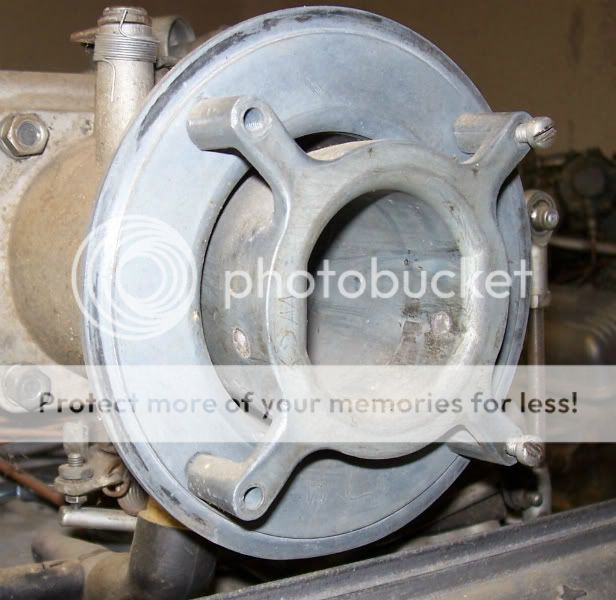

          the '62 air meters use a venturi cone that is open in the center. This revised cone greatly increases the air flow capability of the air meter.
          This '62 air meter had the choke removed for use on a 327-powered sports racer (Echidna) in the early 60s

                Mike, the '62 air meters use a venturi cone that is open in the center. This revised cone greatly increases the air flow capability of the air meter.
                The increase in cfm is real but minor. The greater effect of spacing the venturi cone is to weaken the venturi signal which the fuel meter needs to control nozzle flow. As a result, the ratio lever stops would need to be adjusted to restore the proper air/fuel ratio.
                Jim
                Jim, Old Gail Parsons told me the same thing one time. He said spacing the air meter out a tad did't produce any noteworthy advantage on his test engine/dyno..
                John
