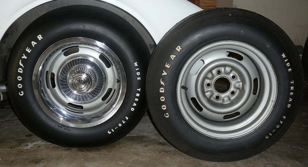

        Hmmm. My Kelsey's have 9 ribs. See attached photo.
        I was aware that the Coker/Firestone Wide Oval's had only 7. Are you sure about Kelsey and 7 ribs? I think I took a 3 point deduct for mine. Can check/report back if interested.
        Hope this helps.

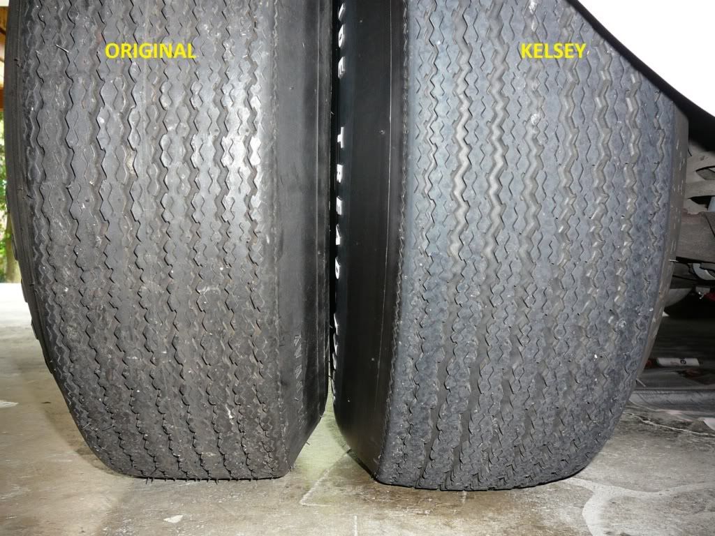

            Re: 9 rib versus 7 rib tire tread pattern
            Kelsey tire & Original spare.
              Hank-----
              So, if absolute correctness is most important, the Kelsey Goodyear Speedway Widetread is the way to go. If some correctness can be sacrificed for better performance and durabilty, then the Coker or Kelsey fiberglass belted tires are the way to go.
              Agreed. Frankly, performance would HAVE to be better with the Coker or Kelsey fiberglass than the Kelsey Speedway. Speedway ride/drive is awful. That's why I keep a set of mounted BFG Radial TA's too. If you look closely at Mike's tread pic, you can (kinda) see that the Kelsey tire has a bit of a crown to the tread surface. The original tire is flat in the same area. Might that be why the Speedway reproduction is so difficult to handle and rough in ride? These repros seem to find EVERY imperfection in the road's surface.
              FWIW, I checked last year's judging sheets. I lost 3 of 30 originality points and 0 of 30 condition points for my RWL Speedway tires. Great for photos. Not so much for driving...
                Originally posted by Don Lowe (44382)
                [/COLOR]
                Don-----
                Don't forget the Kelsey tire pictured is NEW; the spare is FORTY YEARS OLD. Things can change in 40 years. I expect that's the difference between the tread curvature of the new tire versus the old. I don't think this curvature has anything to do with the problems you describe. These tires were always the way you describe. Radials did not years ago virtually completely replace bias ply tires because the bias ply were just as good.
                While the Coker or Kelsey fiberglass belted tires will perform better than the Speedway Wide Treads, don't expect a comfortable ride from either. Fiberglass belted, bias ply tires were years ago the best handling tires I ever had on my 1969 Corvette but they were also the roughest riding tires I ever had.
                The combination of ride and handling of high quality, modern radial tires far surpasses any old bias ply tires. Most folks today have either forgotten how bias ply tires rode or never experienced it in their lifetime. Back in the 60's we thought they were great but only because we didn't know anything else.
                    Joe:
                    Every new/repro Speedway that I have looked at has a crown to the tread while every original (including my WSW spare F/stone Wide Oval) has a flat tread profile. I've paid attention to this, thinking that weaker/different belting may be contributing to the lousy handling on the new tire.
                    I never experienced original bias ply handling/ride. Missed it by just a couple years, but I just can't imagine (but I do believe you) that what I have today was the norm then. Wow!
                    Has anyone compared regular duty performance from a set of original bias ply tires to the same version in a set of reproduction tires?
                        My Kelsey Speedway Wide Treads flat spot - same as your Firestones.
                          Joe:
                          Don------
                          Keep in mind one important thing about every original Goodyear Speedway Wide Tread you've seen: every one of them is about 40 years old and suffers from the same age-induced changes. Now, if we could find, say, a 1 year old original tire we'd have a good basis for comparison. However, I think I can safely say we're never going to find a 1 year old original tire.

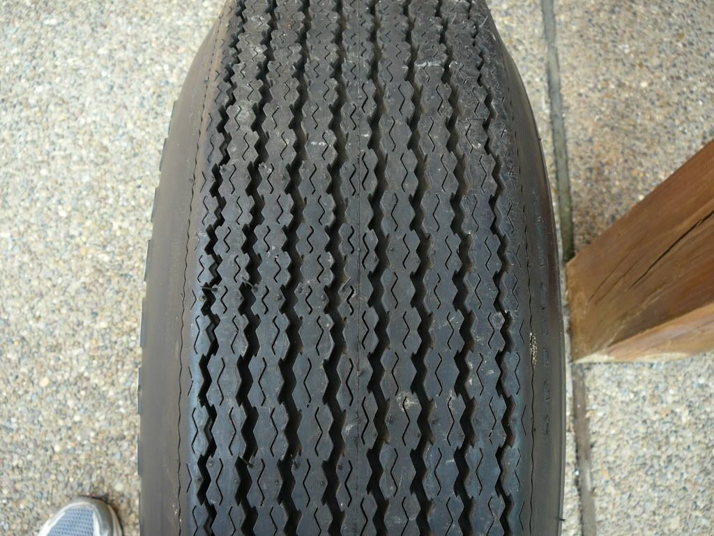

                              Here is a pic from Ralph Spears showing an NOS Firestone tire tread pattern...
                              Kramden
