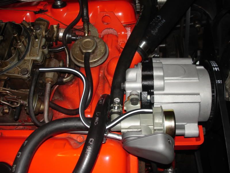

    Welcome to the world of impossible to find 73/74 LS4 parts
    Here's a picture of what it looks like. It is the round valve between the carburetor and thermostat housing:
