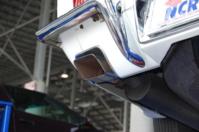

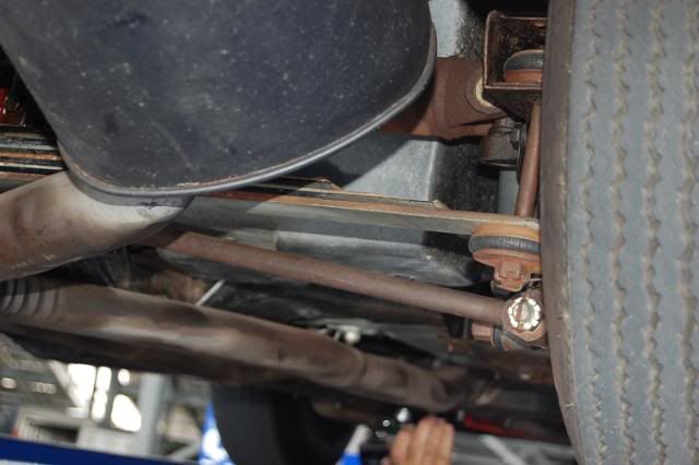

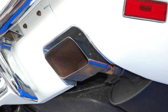

                              Hi Bill,
                              Here are some pictures from a 300 mile car that was at Charlotte in 2010.
                              The originality of this exhaust system might be commented on by others who have seen the car. The exhaust blackout doesn't look heavy and thick as Terry described.
                              Alan-----
                              Do you recall what engine was installed in this car? It appears to have 2" exhaust used only for base engines for 1971.
