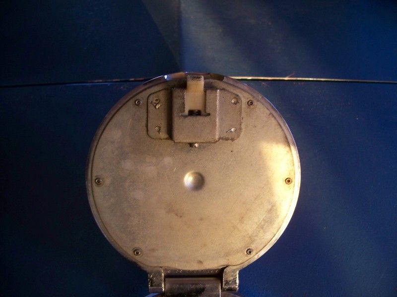

                Re: 1967 gas door spot welds
                this is what I found at Carlisle
                note the 6 spot welds
                this is on dads unrestored original paint 67.
                I do not know if it has been replaced or not.
                • Peter L.
                  • May 31, 1983
                  • 1930
                  Keith - I thing Dad's Gas Door is a replacement. I checked a known reproduction I have and it is embossed with 381440430181 (as best I can tell) by the hinge and it has no line up indentations for the latch, just the 4 welds. My original Gas Door has 38144041 30181-H embossed by the hinge and has the 2 line up indentations on the latch plus the 4 welds.
