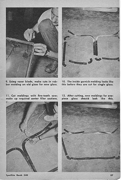

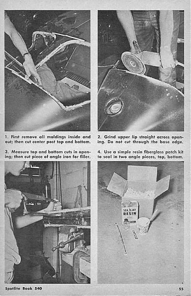

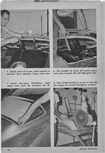

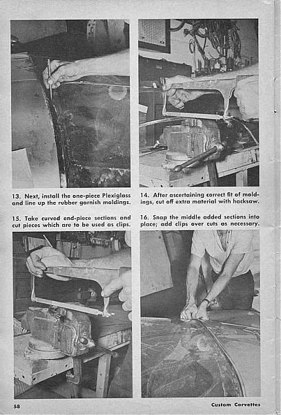

          Bob,
          I think these photos were originally posted by Michael Hanson. Here they are:

            Joe,
            thanks, those are the ones I had in mind.
            He has another mag showing a 63 Z06 getting customized also.

              Bob,
              You're welcome. I have those filed under "ill advised." I'd be interested in seeing 63 Z06 article, too.

                Joe,
                Thanks for posting the article. I would also love to see the ZO6 article.

                  Thanks Joe. I was just about to start looking for the pic's.
