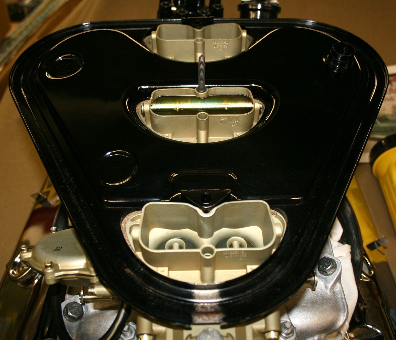

            Here is the base from an NOS tri-power air cleaner assembly I have, dated May 1970. It shows the unpainted hang point...
            Kramden
              • 15596
              Re: Air filter base finish
              I don't have a picture in my files, but I have seen the same kind of hanger mark on 4-barrel bases as well.
