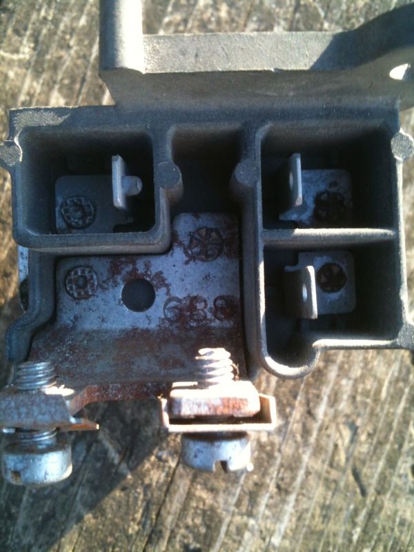

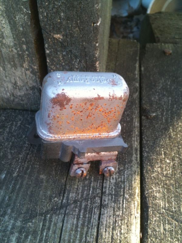

    this relay cam with dads 67 L36 M35 with C60. on the bottom its marked 688
    thanks

    Re: relay ID help please
    Originally posted by Keith Brodbeck (14640)
    this relay cam with dads 67 L36 M35 with C60. on the bottom its marked 668
    Delco horn relay and (I believe) key buzzer should key be left in the ignition switch. Not sure what the application for your car is but could this be particular relay.
      would someone have replaced the original 837 horn relay for this
        If 837 was the original....it appears so.
          okay thanks. does this have any value? what years was it used on

            Keith-----
            The numerical sequence is not "688"; it's "889". It's a derivative of part number GM #1115889. This is a horn relay originally used in PRODUCTION for 1970-71 Corvettes. It became SERVICE for 1966-69 Corvettes after the original relays were discontinued. In your case, the original relay was GM #1115837.
              Same Top. bottom plastic on the original was natural in color and did not surround the terminals.
