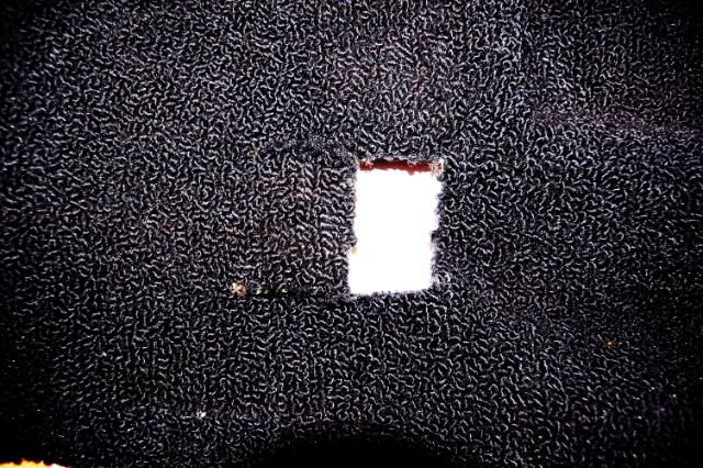

          On my 71, mid-January built car, a small rectangle of carpet was removed right to the rear of the flap. Because of this, the entire length of the track's front feet sit on the fiberglass underbody, not on the carpet
          Here's a picture of the original carpet. You can just see the horizontal slits that form the flap, and the removed area behind it.
