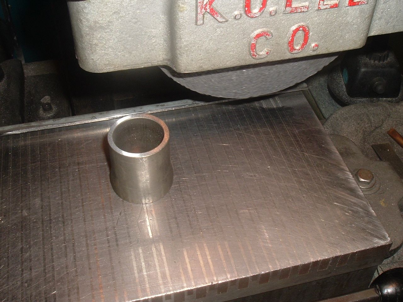

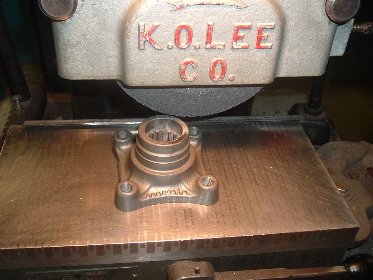

                          The spindle flanges get beat up on the faces. I recondition them and grind them. They come out better then new. These had surface rust and dirt on them but no heavy pitting or stripped threads.
                          The spindle spacers also get beat up. These you have to check or you may find the endplay once pressed on is not what you thought. Also you have to be careful dressing them, sometimes I have to grind off 005-010" and the spacer will be parallel but won't work and will have to be replaced.

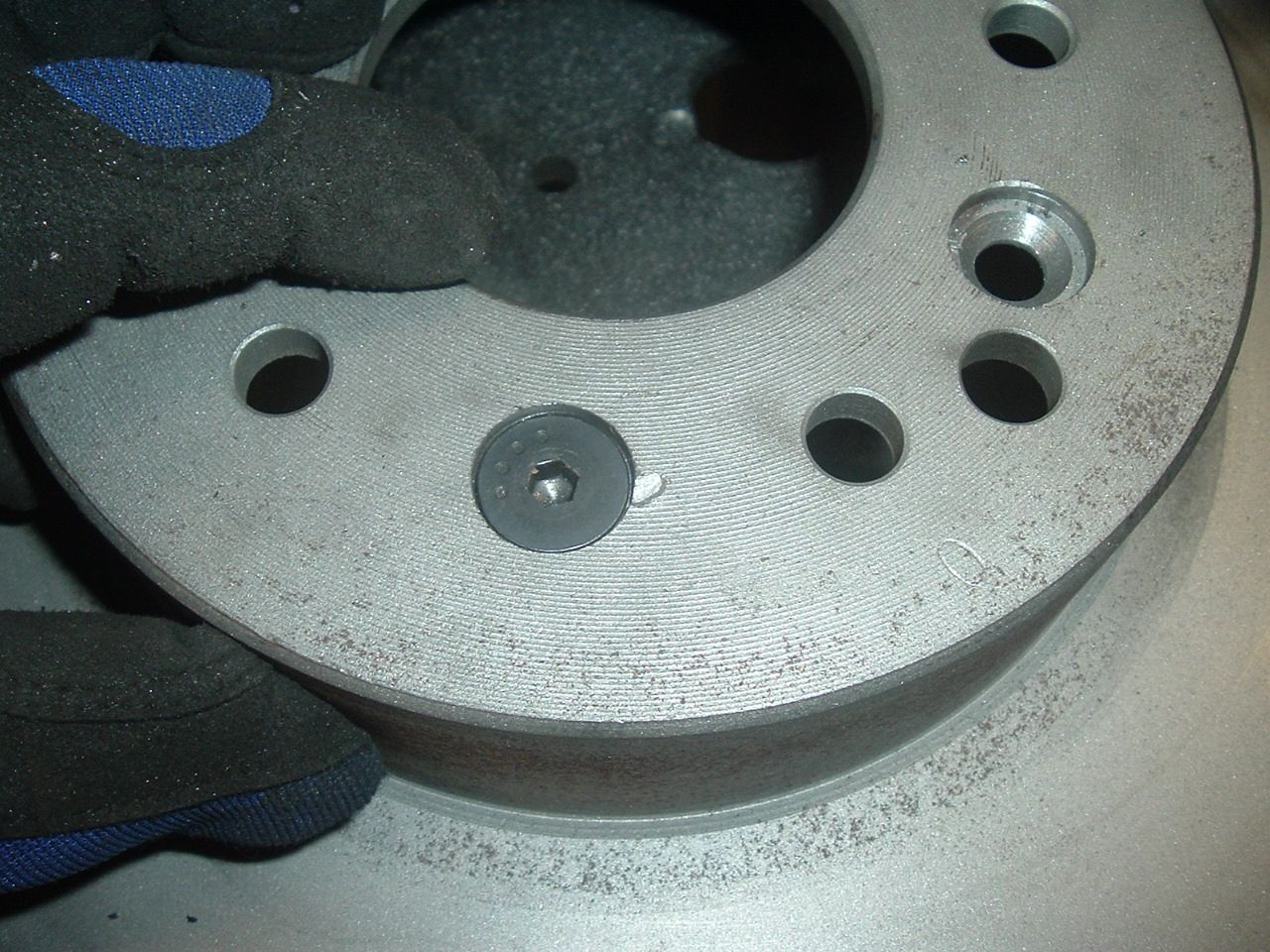

                          Some asked about the flat head installation
