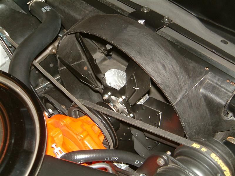

                Here is an original 1972 SB, first design = the same as Mark's 1971 and my 1970
                Edit add: Not to create confusion: there are other differences between 1970, and 1971 to E 1972 than the configuration of the top surface, However the configuration of the top surface is the same for those 2+ years.
