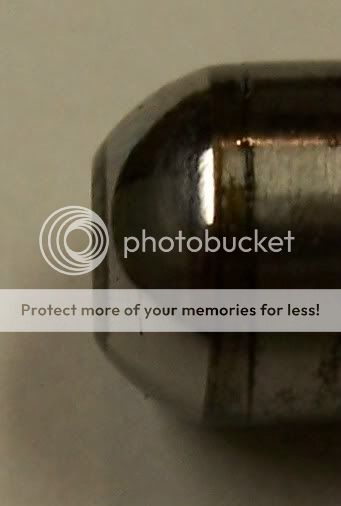

                              Originally posted by Clem Zahrobsky (45134)
                              i would guess the hyd ones did not have the hardened insert in the tip and both ends were just formed. even the ones with a hardened insert had the lifter end just formed so GM marked the hardened end with a blue stripe so you would install them the right way up.
                              These had the blue stripe to indicate "blue side up" when new. The pic shows the tip insert. The other end does not have a tip insert. Purchased over the counter in the early 60s for installation in a solid lifter 327.
