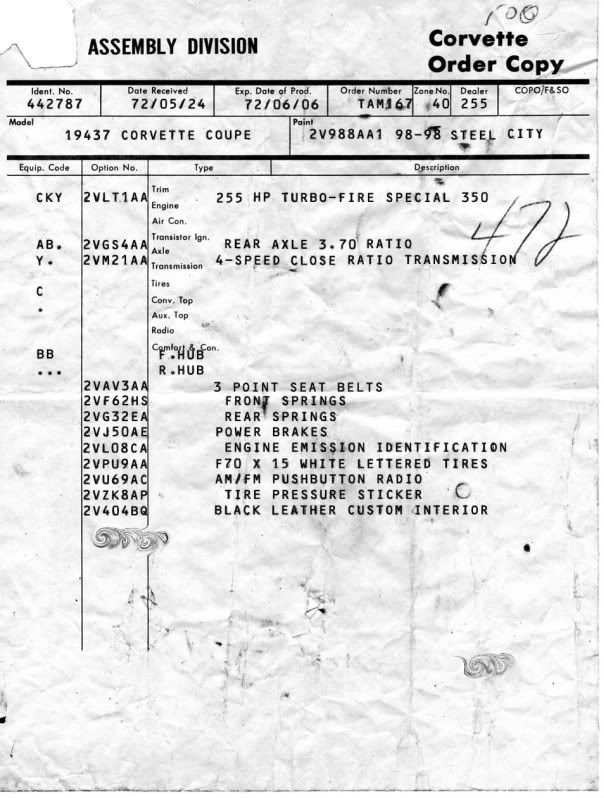

            K19 is NOT listed separately on my LT-1 order copy.

              Don't know how to explain it. Here's an even stranger situation. 1972 LS5 convertible VIN 08130; below is a pic of the window sticker taken while car was on the dealer's lot. Notice NO K19. I also have the GM Canada microfiche which lists K19 and a bunch of other equipment that does not appear on the window sticker; ie. F62, GV5, G32, K19, L08, ZK8, W84. Some of these are identified on Ken P's order copy.
              Mike, do you know where/when the Canadian window stickers were applied ?

                      K19 didn't show on '69-up Camaro window stickers either, as it was part of the basic engine specification; K19 DID show on '67-'68 Camaro window stickers when it was an option and was required on California-delivered cars. If it was part of the basic engine specification and wasn't an orderable option, it wasn't on the sticker.

                          Thanks for all the great input! I was asking because I just purchased a used, complete A.I.R. system for my 1972 LT1 and I was wondering the application possibilities for the system. It turns out that the A.I.R. system that I purchased was removed from an LT1 (I inquired with the seller after posting this thread) and it seems to make more sense now, based upon the responses, most small blocks (other than those prepared for California delivery) did not use the A.I.R. system. I checked the order copy for my car and it did not list K19 seperately either, the car was originally delivered in Colorado.
                          Ken, our cars seem very similar, mine is SS Gray with a black Leather Custom interior as well with no other options other than LT1, Custom Deluxe Front Shoulder Belts, a Heavy Duty Battery, Radio and White Lettered Tires. My car also has a 3.70 rear axle ratio, but paired with the wide-ratio transmission.
