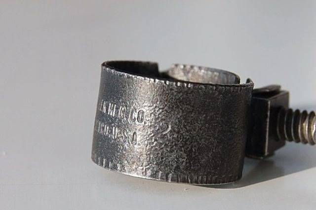

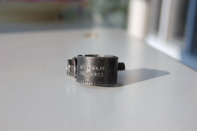

          • 3422
          Re: '69 Expansion Tank to Radiator Hose Clamps
          Hi Floyd,
          Here are a couple of pictures of an overflow hose clamp from my 71 sb.
          I'm not sure how typical the WITTEK and '2' stamps are during this period.
          Except for those markings it appears to be the some clamp as yours.
            I would expect to see a Wittek #2
