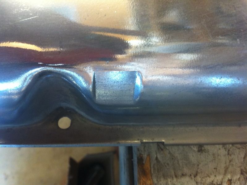

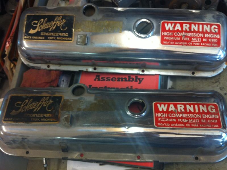

    I have a set of 427 valve covers. The passenger side has the welded bracket for the diverter valve.
    Problem is, these covers are chromed.
    Questions:
    1) Were there ever chromed valve covers in '67?
    2) Are these re-pops?
    3) If these are original, can the chrome be removed without damaging the pieces?
    4) Were these for another GM application?

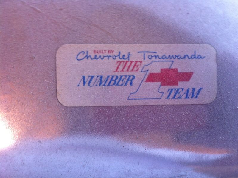

    5) Does the Tonawanda sticker look to be original?

    No chrome valve covers in '67, should be painted. Your covers appear to be orginal but that's best guess.....probably C-3 stuff.

        Further research suggests that these may be Camaro covers?

          Someone mig-welded that mixture control valve bracket and plug wire retainer tab on that cover and then had it chromed; the original chrome covers had the brackets projection-welded to the cover prior to plating, and there's no evidence of any projection-weld marks on the inside of the cover.

            1967 Corvettes with L-89 and K-19 used a valve cover generally configured like this one EXCEPT as John mentioned they didn't have mig welds like these for the brackets. The valve cover was GM #3902390. The same valve cover was also used for 1967 Chevelles and Camaros with big block and K-19.

                Did the above mentioned OTC covers you purchased in the '70's have the "mig" welds for the brackets?
                On another note, did the original "projection" welds ever fail, resulting in the need for "repair?

                  I don't remember any welds except the usual spot welds.

                    I was incorrect in my previous post. The GM #3902390 valve cover DOES HAVE mig welds securing the brackets. When I last responded it was late and I didn't feel like going out and looking at an NOS example of the 3902390 I have. But, I have now (since it was fairly easy to get to). Lo-and-behold it does have the mig welded brackets. I'd completely forgotten about that since I have looked at this valve cover previously. The one I have is a very old NOS piece and probably dates back to the late 60's or very early 70's.
                    Given that the Tonawanda label looks to be original on the cover you have, I expect your valve cover was originally installed on a 1967 Chevelle or Camaro with K-19.

                        The Tonawanda label was affixed at the engine plant on valve covers that were part of an engine assembly. My cover is NOS and was not supplied as part of an engine assembly and never saw the inside of the Tonawanda engine plant.

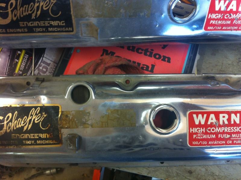

                          I did not notice these "indents" in your photos until I looked at mine again.
                          Please see photos below.

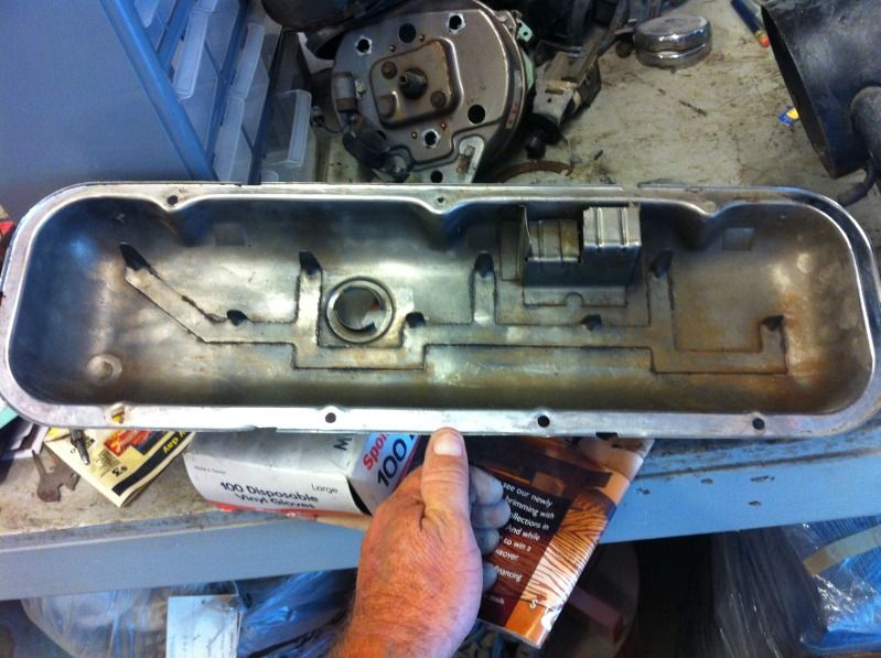

                          Below are some photos of what I believe to be the matching left hand valve cover (I do not know this as certain)
                          The plug wire support has a "tab" with hole, presumably for throttle return spring. There is another hole 3/4 up on the support tab.
                          The rear of this cover has a decided "slant" to it as compared to the cover in the foreground.
                          Finally, there is a "thumb print" raised area on the rear inboard portion of this cover.
                          This cover, unfortunately, is in poor condition compared to the right hand cover. But again, I am not sure this is the matching piece. I have a few of these, amassed over the years.
                          I like the decals on these next two covers:
                          These are both right hand pieces; neither have spark plug wire tower supports, one has three (two inboard and one outboard) wire support "clips" and the other does not.

                            George------
                            The number of variations, minor and major, in big block PRODUCTION and SERVICE valve covers over the years of their use and availability are HUGE.
