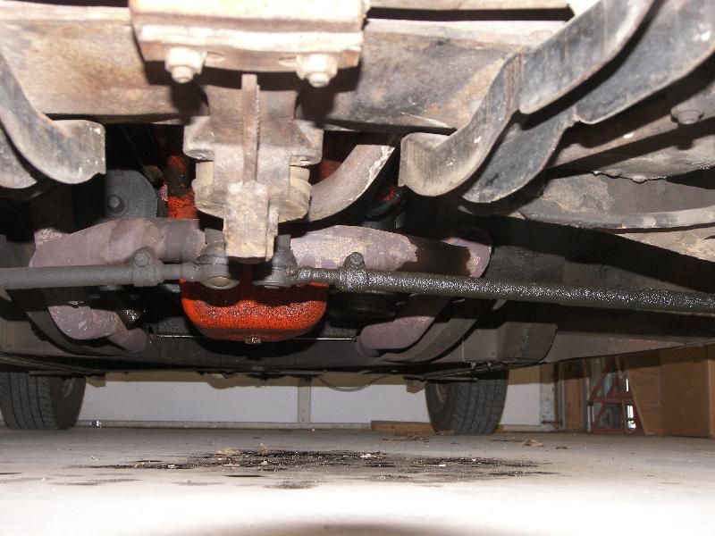

                    I just happened to have my camera with me today when I was in my shop so I snapped a couple of pictures of the tie rods on my '60. The car is suspended by its original springs. It's a safe bet the tie rod angles in the picture are what the judges were wanting to see.
                    FWIW....
                    Jim
