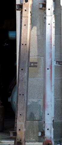

        I ordered one for my 58 but it only has 7 holes and my old one had 9 holes. Do you know how many holes it suppose to have?

            See Al's reply for number of holes. The head faces down toward the pavement. GM replacement parts decades ago superceeded the earlier piece with the '58 up piece.

              two versions

                Thanks for the picture. I had to drill the holes on each end near the leaf spring brackets. Not sure why the new one didn't come with holes already drilled.
