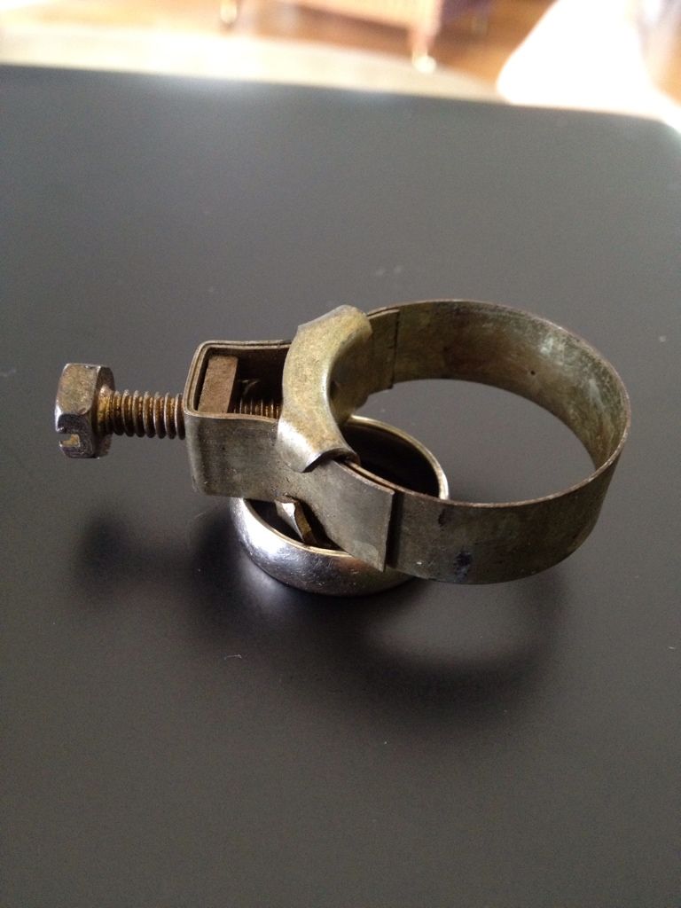

    Chuck,
    I believe the DCM clamps were only used on the larger hose. The smaller hose used Whittek dated clamps. The DCM clamps are non dated. I was always under the impression DCM indicated dichromate wash.
    This is an original clamp with an incorrect finish...

                            Courtesy of Robert Jorjorian, here is a beautiful original finish DCM heater hose clamp...

                              Nice prop in photo one fly boy. Does your wifey know you use the ring for that? Last photo looks like you have a cold one or two on hand. See you in Altoona.
