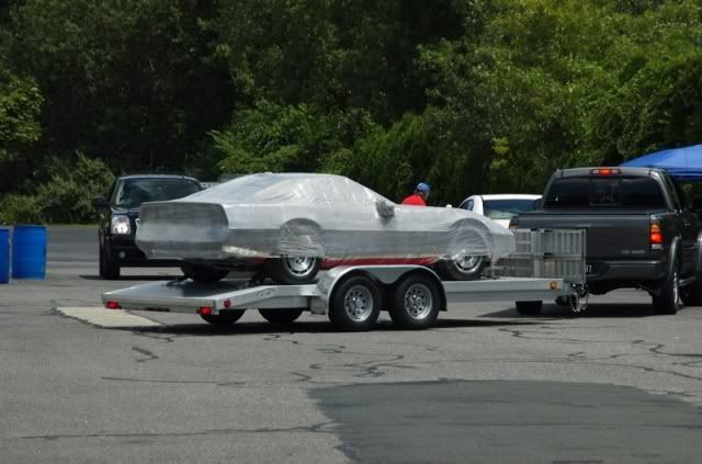

    How about Saran Wrap Um?

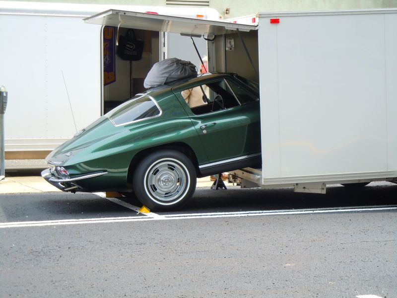

      Always be certain to tie your load securely BEFORE moving the tow vehicle!

        FWIW; my son tried using "Shrink Wrap" on his 08 PC for our trip up to Indy last May. He applied it only over the front end and around the flip back side mirrors to help against splash back of sand and grit. It proved to be more trouble than it was worth (putting it on and taking it off), and was proved to be unnecessary. On the trip back, we loaded the car in a hurry due to an impending thunderstorm, and he drove all the way back tp Florida with it that way. It looked none the worse for wear on arrival here than at Indy.
