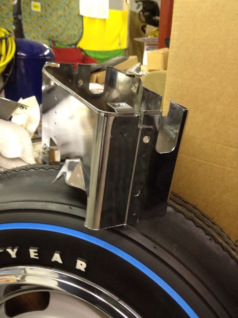

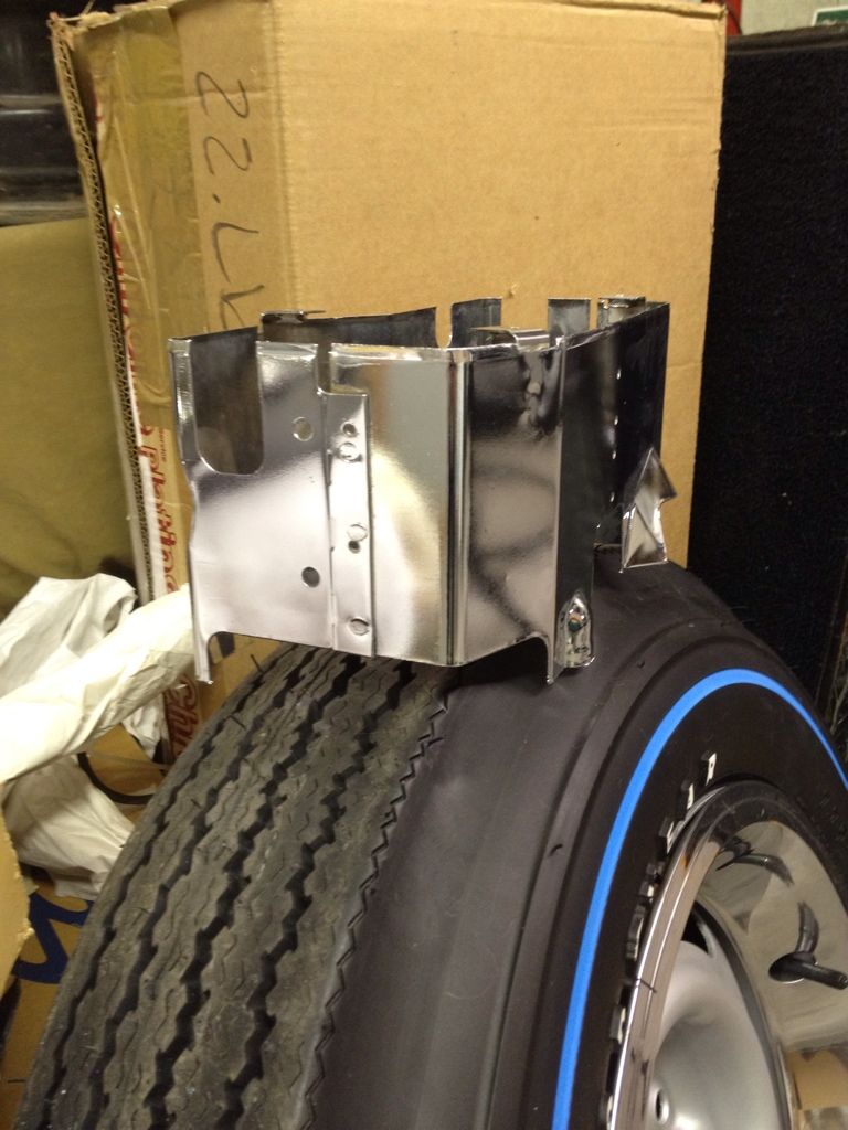

                              Here is the bottom of a service assembly I purchased for my 69. It is spot welded on both sides. Is this what you guys are calling a three piece assembly (if the top were pictured)?
