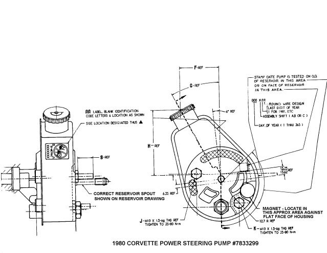

                          Little known fact: most original Corvette power steering pumps had an INTERNAL fluid filter. This was shared with some MD/HD truck applications but no others. Unfortunately, elements for these filters are long-since GM-discontinued and not otherwise available. Commercial rebuilders generally remove the filter and element when they come across them. So, once a Corvette pump is rebuilt it usually loses its filter.

                            The internal filter is something I was not aware of. I am going to try and find an engineering retiree that might remember about the filter.
                            For a short period of time, (back in the 70s or early 80s) there were some lawsuits that alleged that at 2 A.M. in the morning (after only 1 beer at the bar) the plaintifs power steering "locked up" and there was a collision as he/she was driving home. The alleged "lock up" was caused by very fine particles that jammed the rotary valve in the steering gear. We called them "particles cases."
                            One of the things that our engineering experts would do just before a trial was to purchase a car similar to the complaint vehicle. Then install a complete new power steering system in that vehicle. Then we would make a video or movie of us collecting floor sweeps, chips, and other debris from the manufacturing plant. Then we would take a paper cup full of that debris and pour it into the pump reservoir. Our engineering expert would then drive that car all the way to the site of the trail. (Many times this was across the USA.) At no time did we ever experience a "lock up" as was alleged. General Motors never lost a "particles case" with this type of engineering demo.
                            After we won a couple cases with this type of demonstration, guess what? The "particle cases" ceased. (Lawyers have a real network for jumping on certain types of product litigation cases.)
                            This isn't to say that people should become careless with respect to rebuilding pumps and gears.
                            The above is probably one reason why the filter eventually disappeared from the Saginaw pumps.

                              The filter assembly was GM #5689351 and the element was GM #5689352. They were used from 1963 to at least 1973. I have a few NOS examples of the filter assembly and many of the element.

                                I see that the filter and element were inside the reservoir right behind the return spout. It does show up on the early pump assembly drawings. You just have to know what you are looking for. The filter does not show up in the 1975 Corvette pump, (there is a magnet inside the reservoir.)
                                BTW, I am pretty sure that the filter was eliminated when the little round (hockey puck) magnet was added to all the Saginaw power steering pumps or steering systems.
