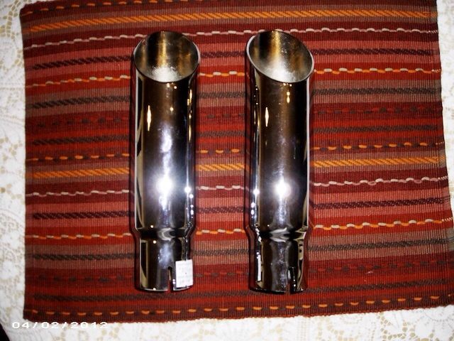

    Seeking comment on whether these appear to be originals or repros

    They look too short to be original and the clamps are wrong.

      I agree with Graeme.

          I believe that assembly line tips had 2 slits. All service replacement tips that I have seen have 4. I tried to upload a photo of a pair of rechromed originals that I have but I couldn't get it to work. Maybe if someone could instruct me I can post a photo.

              These are not even reproductions. They are some sort of aftermarket-type piece.

                    Believe it or not they look like NOS AMC Chrome Exhaust Tips.

                      In addition, most repos are Stainless Steel, originals are chromed mild steel. Check it with a magnet.
