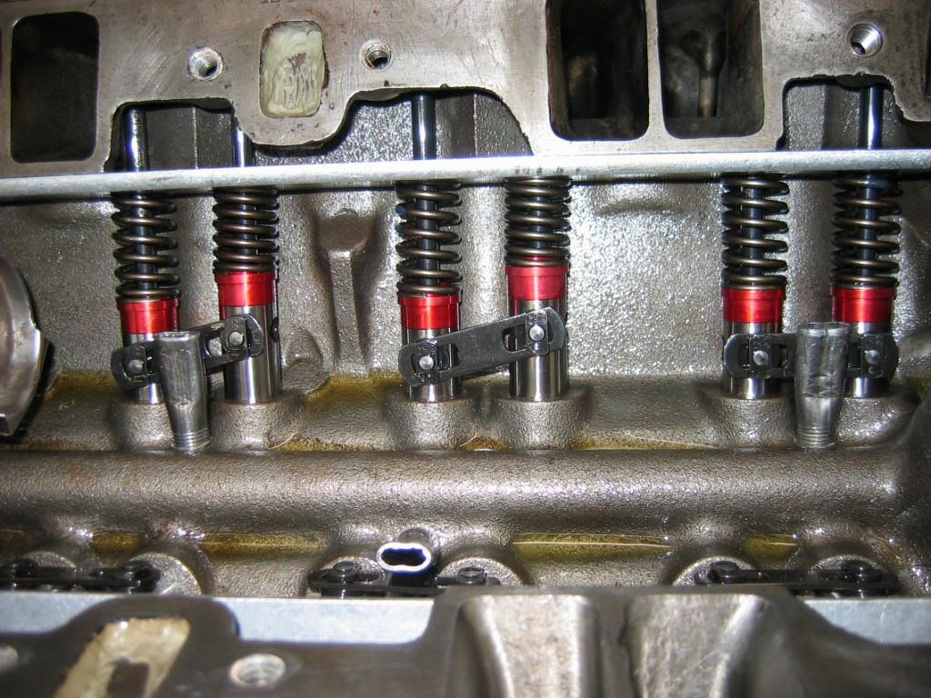

                                Great advice, but I doubt if the OP would go with a solid roller since they generally have faster ramps and higher lift than hydraulic rollers. Even the mildest hydraulic roller would still be somewhat more aggressive than the 929 cam, while at the same time providing more durability than even the mildest flat tappet cam. Rev kits are not necessary with hydraulic rollers since engine speeds will generally prevent the lifter from losing contact with the lobe at POML, and the resultant catastrophic lifter shattering when it lands back on the lobe. I've used Comps Endure X solid roller lifters which are all pressure fed through a very small EDM hole injecting oil directly at the rollers and needle bearings. Another great thing about roller tappets is that there is no danger in installing standpipes in the lifter gallery oil return holes, which saves windage due to much reduced oil splash onto the crankshaft from above.
                                http://img.photobucket.com/albums/v2...s/IMG_0044.jpg
