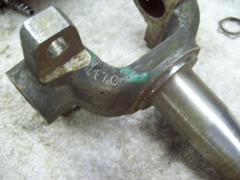

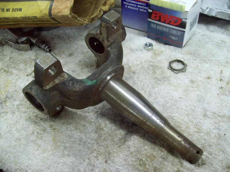

                See pics below of the two knuckles/spindles I have. You can see the casting numbers and marks in them. I'm hoping to find out if "3693446" was the casting/part number for all C1 corvettes, or just 59...

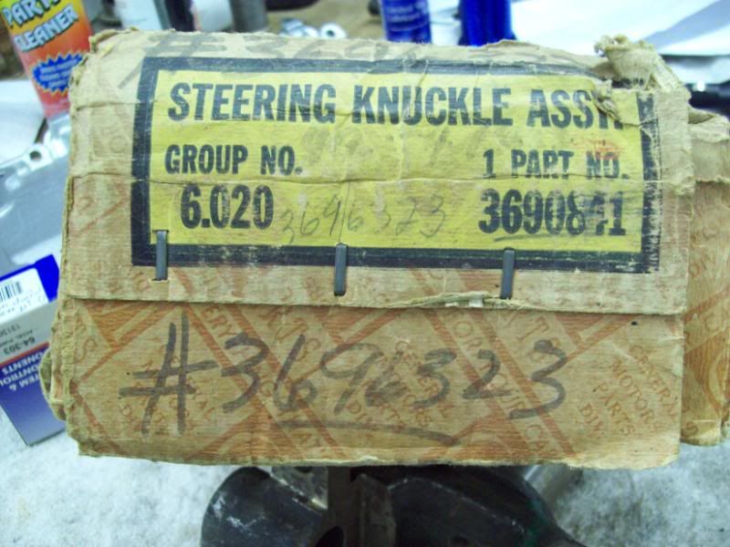

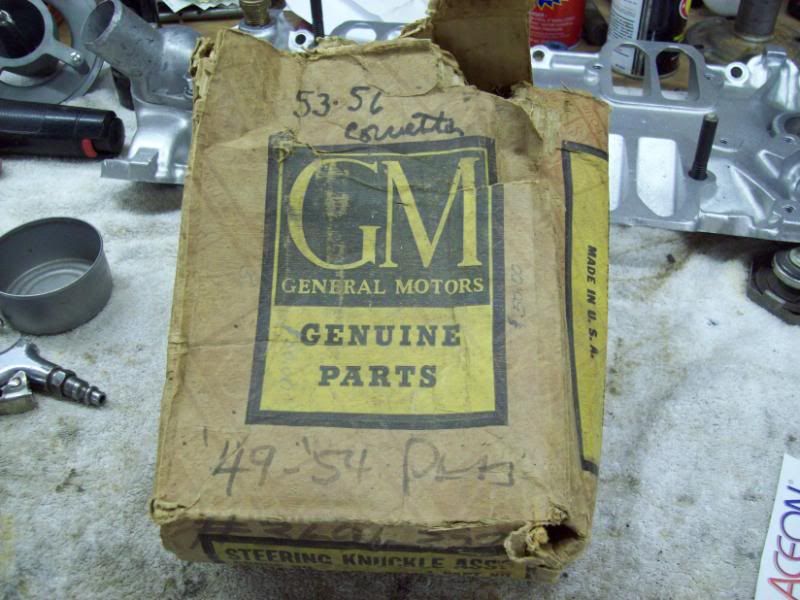

                  I have one NOS in the box spindle (that's what I call them also). It has 170 and no letter that I can find. I also have a nice used spindle with 329 on it and no letter. No numbers can be seen on the spindles of my 51 or the 56 because MANY years ago they were chrome plated and everything was polished off of the parts for chrome plating.
                  As you can see below, the spindle is called Steering Knuckle Assy. I have no clue why the part number was changed to 3693323. This NOS spindle must be a very early part, both because of the old box as well as because it has 49-54 pass car and 53-56 Corvette written on the box.

                          • 43271
                          Re: C1 Spindle casting number
                          Ian,
                          Tom-----
                          The GM #3690841 is a very old part number. It dates back to prior to 1953, so it was probably never actually used on a Corvette. However, it's application was 49-53 passenger car so it should work for any C1 Corvette. It was replaced by the GM #3696323 (as indicated on the box) in April, 1953.

                              Thanks Joe. Something I notice when I look at Tom's picture is the part number was 3690841, while the forging number is "170". Too bad it's just the 3-digit number. Makes it hard to tell what the part number might be...
