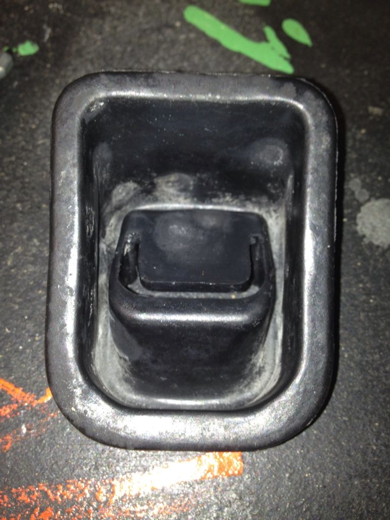

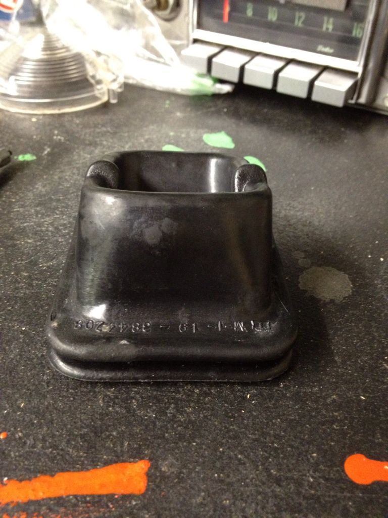

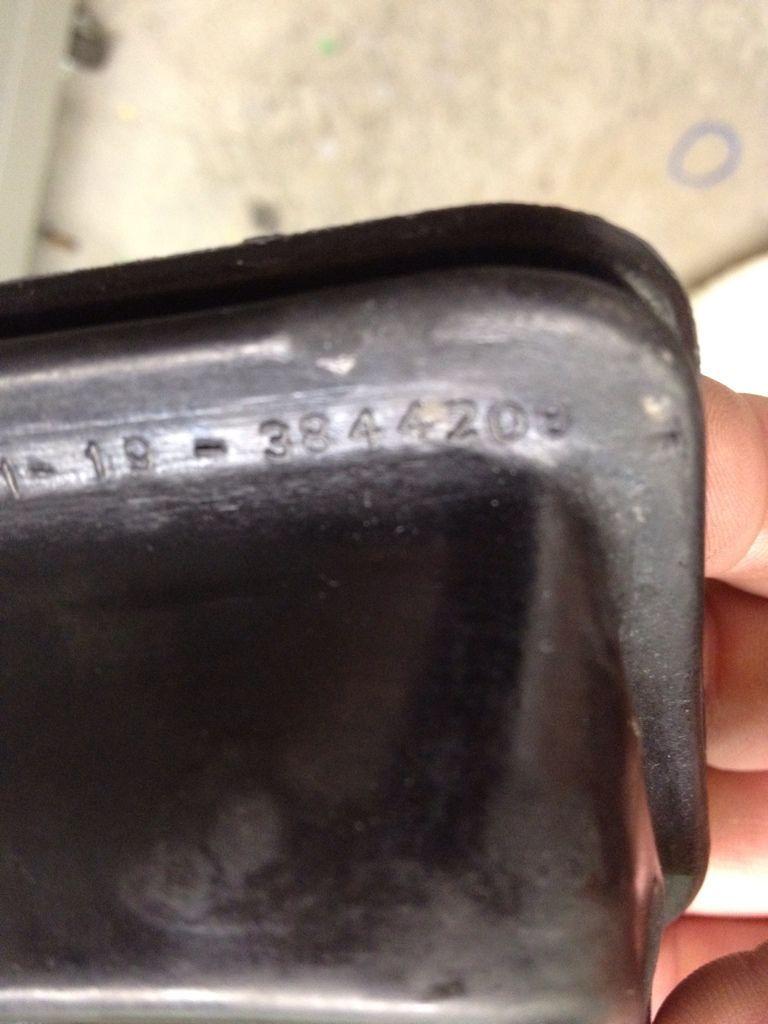

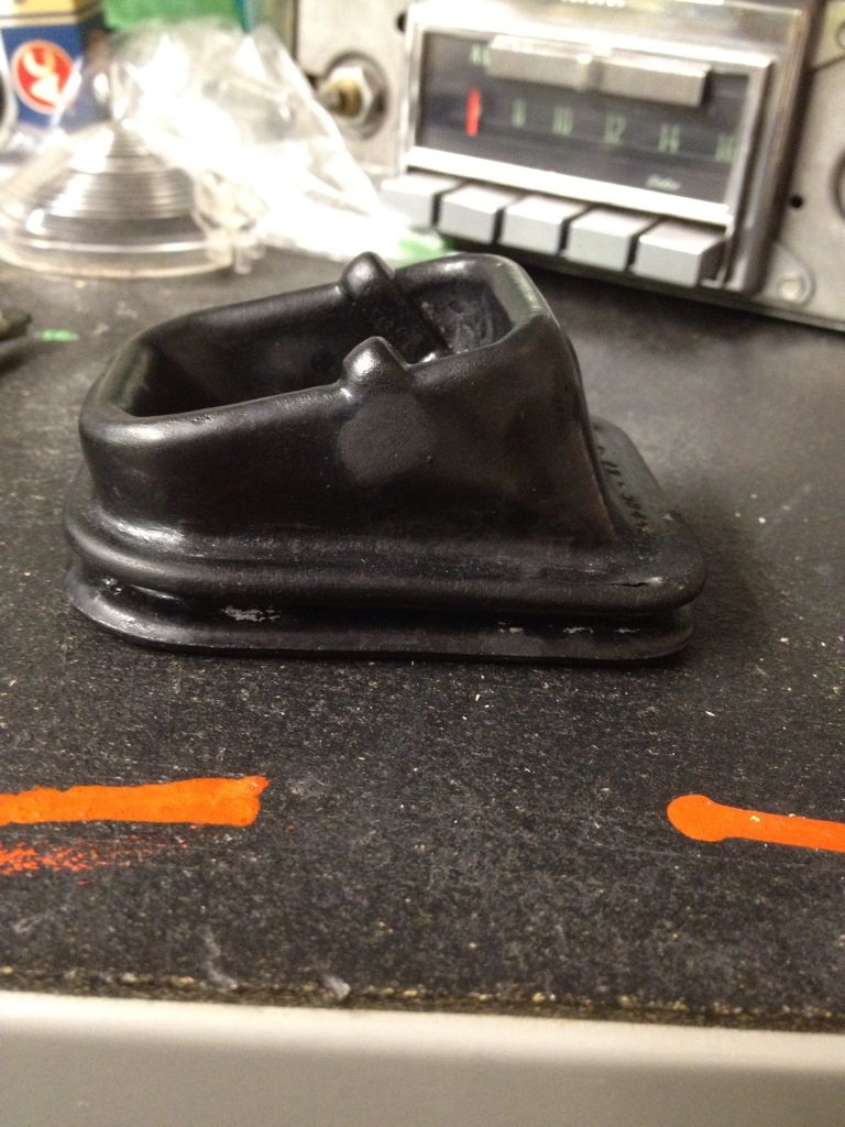

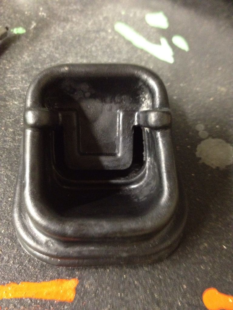

      There were TWO clutch boots used in PRODUCTION over the 1965-81 period. From 1965 through 1972, boot GM #3844208 was used. From 1973-81 boot GM #3993851 was used.
      Boot GM #3844208 was discontinued from SERVICE in October, 1965 and replaced by GM #3841738. The latter was discontinued in August, 1971 and replaced by the GM #3993851. Finally, GM #3993851 was discontinued in December, 1982 and replaced by GM #14007355.
      I don't have an example of the 3844208 but I do have NOS examples of all the others. They are pictured below. The only difference I can discern between the 3841738 and the 3993851 is the type of rubber they are molded from. The earlier part is a stiffer type of rubber and the latter is much softer and more pliable. Otherwise, they appear the same to me. The 14007355 is also molded from the softer rubber but is also configured a bit differently than the earlier boots.
        • 43221
        Re: Clutch Fork Boot
        A few more. Also, note that the "sag" at the top of the 3841738 is not part of its design but simply the result of long storage in the package.

            Thanks for the PICs. Here is a pic of an NOS 3844208...
                Mark------
                It will be interesting to see what original boots on cars look like. I just do not recall the original boot on my car being configured like the 3844208. Of course, it's been a LONG time since I replaced it and my recollection is "cloudy", at best.
                It may very well be that the change from the 3844208 to the 3841738 occurred for PRODUCTION about the same time it occurred for SERVICE but was never changed in the AIM's. Or, it may be that both were used alternately in PRODUCTION. Certainly, both were released about the same time.
