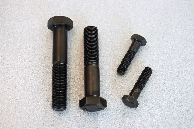

      Re: 70 Rear bumper brackets and hardware finish
      The bolts look great. Whose product did you use?
      Also, are the lock and flat washers natural or cad plated?
      I am constantly amazed at all your pictures Alan.

            Hi Bill and Pat,
            Thanks for the compliments.
            I've been very fortunate that the vast majority of the parts on my 71 were restorable. Those bolts were done with the Caswell Black Oxide materials. The blackening goes very quickly after the parts are prepped and scrupulously cleaned. They also supply a sealer that you dip the parts in immediately after they come out of the bath. The sealer gives them a good appearance and protects the oxide, but I've found it takes about 3 days to dry so the fasteners can be handled.
            I'm also setting up Caswell's small copy cad/ zinc system. It's more involved than the oxide, but I'm hoping for good results based on what I've read here on the board. I'm redoing fasteners that I plated with an even smaller tin/zinc system about 10 years ago.
            About the rear bumper bracket washers and nuts.... I'm not sure of their finish; perhaps someone else can help you with a reply!
