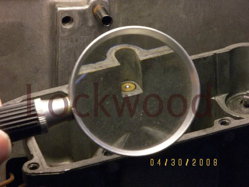

                            Expanding on what I wrote earlier.....
                            FI units which initiate starting fuel flow by way of a cranking signal valve have no source of nozzle fuel pressure other than the internal gear pump. Break a pump cable and the engine shuts off immediately and will not re-fire, not even momentarily. Such units include 4900, 7200, 7250, 7320, 7360, 7375, and maybe a couple of other seldom seen models.
                            For FI units with a starting fuel bypass circuit, nozzle fuel pressure during cranking is provided by the engine mounted fuel pump. And, compared to normal idle fuel pressure, the cranking fuel pressure is very high. As a result a LOT of fuel flows during cranking and the engine can easily run for several seconds on just the residual cranking fuel. Units configured with starting fuel bypass mechanisms include 4360, 4520, 4800, 4960, 7300, 7380, and maybe a few other obscure models.
                            If there is an ignition problem..... say the ballast resistor has opened up.... even if the engine fires during cranking, it will immediately stop as soon as the key is released back to the "ON" position. There will be no delay. None. Zip. Zero.
                            In the case of Richard's FI unit, a 7380 model, it's providing starting fuel and the engine is getting ignition. What the engine is not getting is a sustained supply of fuel after engine cranking stops.
                            The symptom he has described is completely consistent with what happens when the internal anti-siphon check valve becomes dislodged from its cavity internal to the fuel meter. This isn't a common occurrence, but neither is it unheard of.
                            The picture below shows the anti-siphon check valve. It's the tiny brass thingy visible through the magnifying glass. (This particular check valve has failed, but it hasn't been dislodged from its cavity.)
                            Jim
