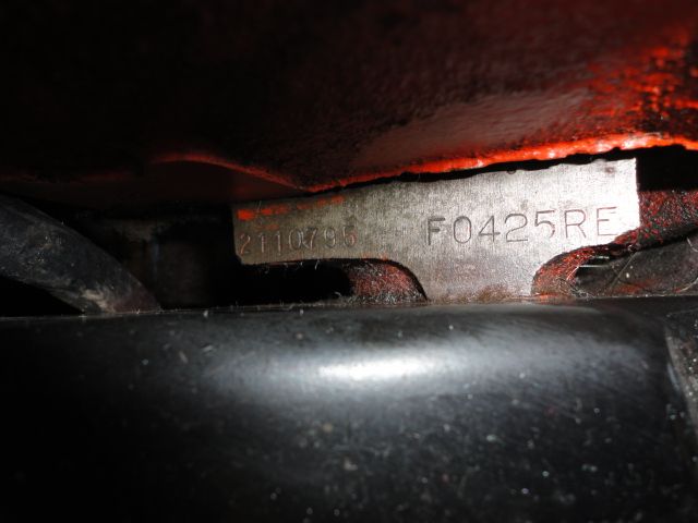

    What your thoughts on this 1962 corvettes stamp pad????

    Looks fine to me.

      I like it. Bill

        I agree it looks very nice

          Question: what position in the holder is the "5" in to achieve that stamping?

            The holder has nothing to do with it. Either the 5 was flattened on the end of the lower curve or there is a slight depression on the pad at that spot.

              Why would there be a slight depression in a pad that was broached flat?
