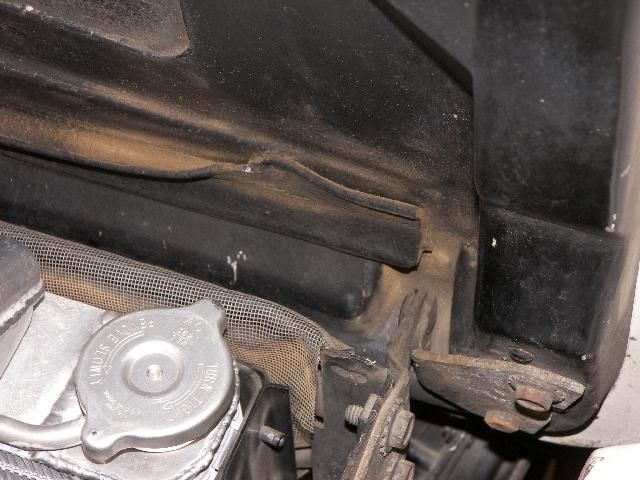

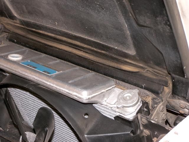

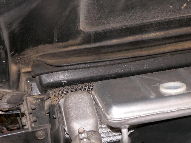

                I agree. My FI '60 has the original seal intact and in position. I'll make and post a picture later today.
                Jim
                • Jim L.
                  • September 30, 1979
                  • 1817
                  Re: 1960 front hood seal orientation
                  As promised:
                  The forward seal visible in these pictures is original to my car, which is an example of April production, in case that matters.

                    Jim,
                    I can't tell from the photo, what does the seal rest against when the hood is closed?
                    Dennis
                    • Joe M.
                      • April 30, 1990
                      • 1343
                      The front, top corner of the radiator. It creates a seal so that air does not go over the top of the radiator. It works in conjunction with the 3 piece seals down at the bottom of the radiator, one on each side and one seal in the center. The center seal is worthless for directing air flow, but required for NCRS judging.
                      • Jim L.
                        • 1817
                        Yep. What he said....
