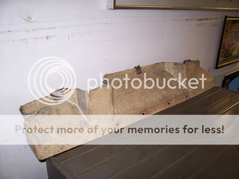

    Question 3: Was the lower Radiator baffle...behind the front grill painted??? I replaced my baffle and am wondering whether to leave it bare fiberglass or painted?

          This part from my '59 was blacked out with the inner grille area. I've stripped the black off mine. The backside is raw fiberglass with just a hint of black overspray.
