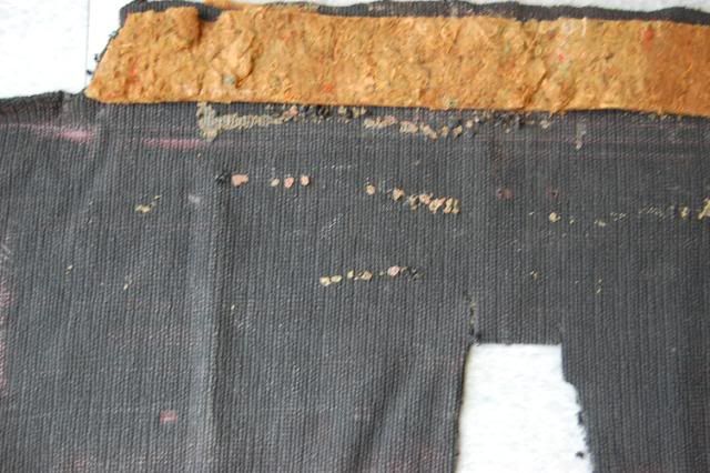

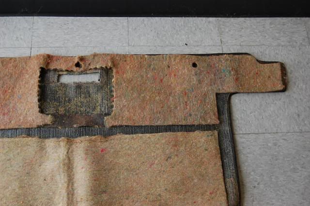

    Hi Paul,
    Here are a couple of pictures of the padding from my 71. I believe the padding used on your 69 is similar
    I don't think anyone is making anything very close to it these days.
    Hopefully this will give you some idea of what to look for.
    Any chance you can reuse your original pads?
    This padding was hit and miss glued to the carpet.
    Rear wheel housing
    Seat bulkhead
    This padding was loose from the carpet and had a dense (rubber ?) coating on the carpet side of the padding

      Nice pictures Alan. Those are some of the best carpet photos I have seen.
