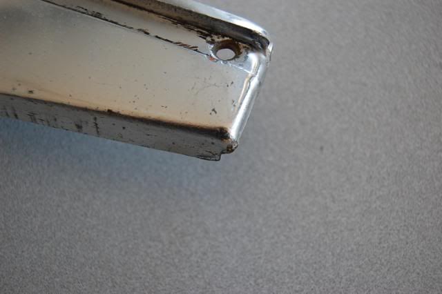

      One way to determine a service replacement from the reproduction may be by closely looking at the ends of the moulding.
      The reproduction mouldings are quite poorly formed and the metal has been kinked to arrive at the approximate shape it should be. The original and service replacements are more evenly formed.
      Here's a picture of the rear of a reproduction panel. You can see the bottom of the lower corner was allowed to kink in order to form the rear lip on the panel.

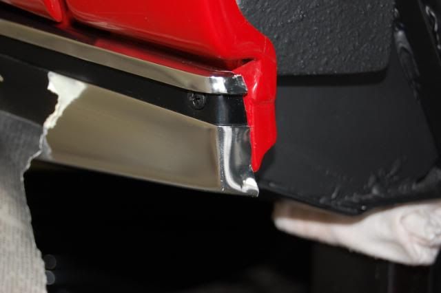

      Then a picture of an original w/tab, showing the same area is much more cleanly defined and formed.
      Hope this helps!
