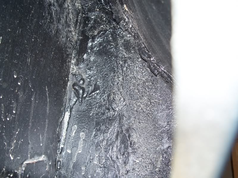

    I have three 67s at the house two St. Louis bodies, and one A.O. Smith body. on the two St. Louis cars there are two holes in the drivers side inner quarter panel at the back. it looks to be were the 65-66 power antenna was mounted. and the A.O. smith body does not have these said holes. all three cars have what I believe to have the original inner panel. is this a common thing or what

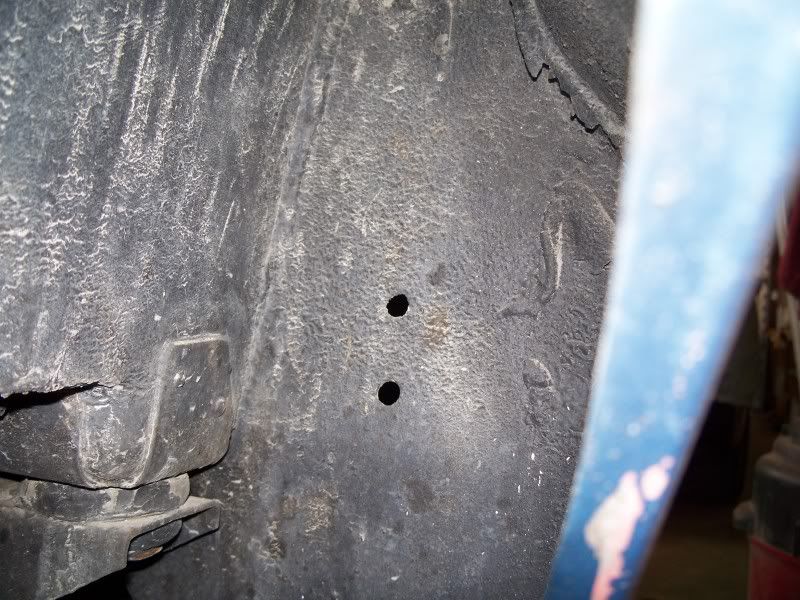

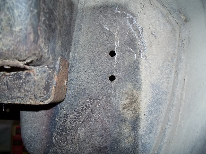

          Re: 67 drivers side inner quarter panel questions
          June St Louis coupe
          Nov St. Louis convertible
          June A.O. Smith coupe
            My March 3rd car with STL body has these same holes.
              Looks like the St Louis plant was using up the remaining inventory of 65-66 panels with the holes for the 65-66 antenna, on 67's.
