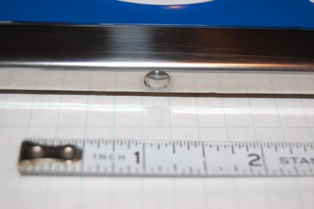

            Re: Original license plate frames
            Hi Kurt,
            Here are 2 pictures of 1 of the rivets from my 71's original frames.
            I hope they're a help to you!
            Regards.
            PS: I see now I should have slid that tape over to the left just a 'hair' !.
