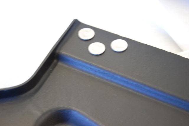

      This is correct. Both sides of the tray have a high gloss appearance to them and while you can clearly see the fibreglass strands through the finish it is dark black in color.The hinges are unfinished steel.72 Window Tray.jpg

        The tray itself does seem to be painted though. I took a cpouple of pics to show what I found.
        First is the hinge. Second is the area near rthe lock, notice the diffrence in color, some appears to be natural glass and some appears to be painted. The third picture shows what appears to be a run or drip in the paint.
        I'm leaning towards paint since there is no indication of overspray on the rivits, brackets or trim that may have come from a later restoration of the tray. Let me know what you think, thanks!!

            I agree, your tray certainly looks like it has some paint on it.
            It'll be interesting to see what Edward discovers.
            My tray (71) was in such good condition that all I did was wipe it off with a damp cloth and dry it. So the pictures show pretty close to what it was when new.

              My tray is definitely original, never been out of the car or touched in any way by the original owner. Alan's photos show/depict exactly what my tray looks like, hence I didn't bother posting any add'l pics.

                  Lynn, I Did look at my tray, and it does appear that when I dropped it down and cleaned the dust off it, there was definitly a small area missing some paint. and could see the glass was more like a dk. gray under it, also it appears that if they were painted it was done before any of the hardware or hinges were installed all of my rivits were unpainted as were the hinges. and there was a aluimnum piece that was unpainted. PS my tray was still installed I could not tell if the bottom was painted because it appears perfect, as it wasn't used much as it appears. Rick your apppears like it was way to shiney amor all maybe, mine appears like Lynns and Alans a flat or semi flat black.

                    Your comment was not lost on me though, so I went and looked again at great length and while the flash used in my pic does seem to suggest it is "glossy" I would say that it appears somewhat exaggerated in the photo. In normal light it has a definite sheen or lustre to it but would only place it at the higher end of semi-flat and shy of gloss.
                    I can say with certainty no touch-up or restoration has ever been done on it. The car only has 70K miles on it and I am second owner. I will say that the glass certainly is darker than what I usually expect to see yet no signs of an opague "paint" or top coat ever being put on it. Certain areas that have light scuffs/scratches show nothing suggesting that a coating of any kind has been disturbed or cut through unless it is an absolutely thin coat of clear that the manufacturer put on as a final means of dressing this piece. And if this is the case it would have to have been put on to the glass prior to rivets and metal trim pieces were applied as they are natural and without over-spray of any kind.
