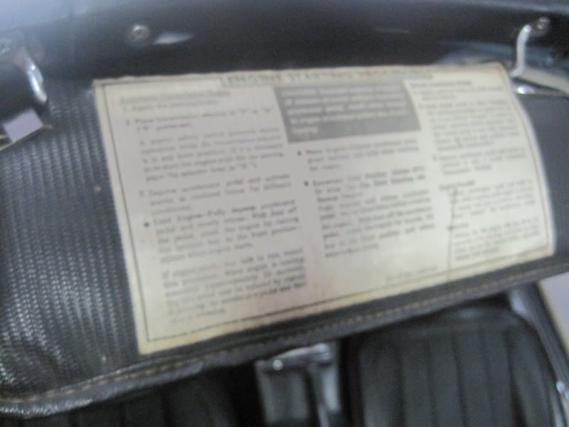

            Re: Starting instruction label sleeve
            for illustration purposes a picture of a very original 72 that we flight judged 2 years ago: sorry bit out of focus pic though
