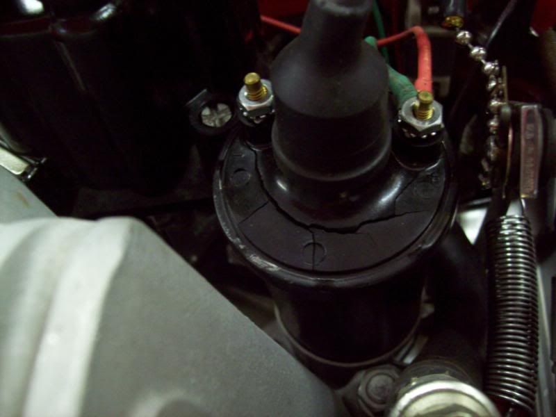

                        I've been running the 1181 on the 56 for years with the PerTronix Flamethrower coil. I left the stock ballast resistor in place, NEVER a problem. A couple of years ago, I ran a jumper wire across the resistor terminals.
                        This was the result---------------------the jumper wire is coming off!!!

                          Tom, That is interesting, the Pertronix people say to run the coil with battery voltage, they say the resistance is built in. I measured mine it is 1.5 ohms on the primary side I measured a pair of stock coils the 3.1 and 1.8. This indeed may be a problem that will show up in time for all that have used these Pertronix systems. Larry system is 10 years old, mine is about 3 and still seems to be working but time may not be on my side. Did you happen to contact Pertronix? I also wonder what affect having these(Pertronix coils) under the shielding has in keeping the heat from disapating.
