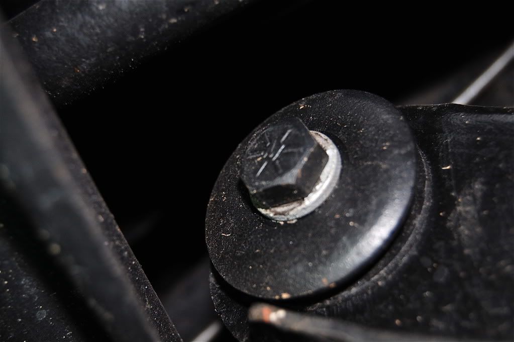

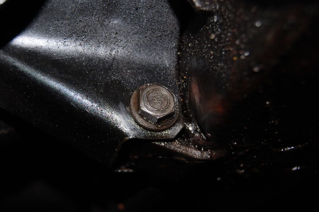

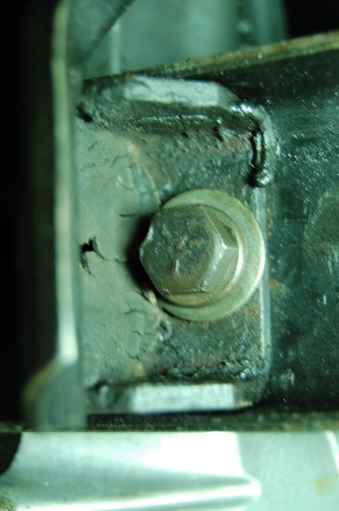

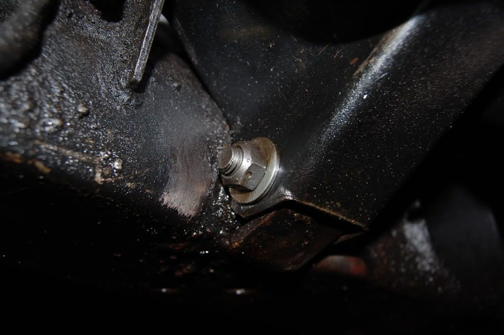

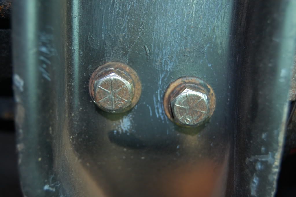

    I decided to document the head marks on the Chassis bolts of my father's rusty 66 Big Block. For the most part, his car has never been apart-minus the front suspension that i rebuilt this past spring, but all original bolts were reused.
    Production date is early June of 1966. I have made notes of head mark differences from his car to mine. My car was produced in Mid April 66.
    Starting from Front to Rear
    1. Lower Radiator Support- WB headmark with 3 lines
    RSC Mark is on the upper radiator support bolts, but i do not have a photo currently.

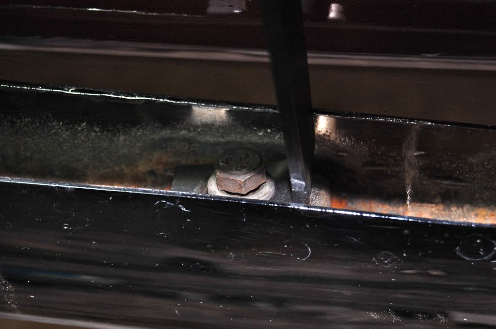

    2. Front Body Mount/Radiator support bolt. RBW with 3 lines
    3. Front Bumper Bolts- RSC This is the same for the bolts that hold the supports in place on the frame as well.
    NOTE: Bumper to front of center frame mounts are Black Phosphate with WB headmark

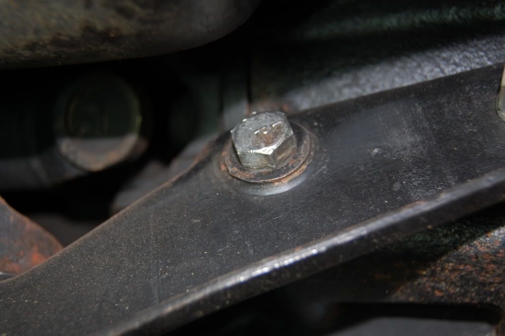

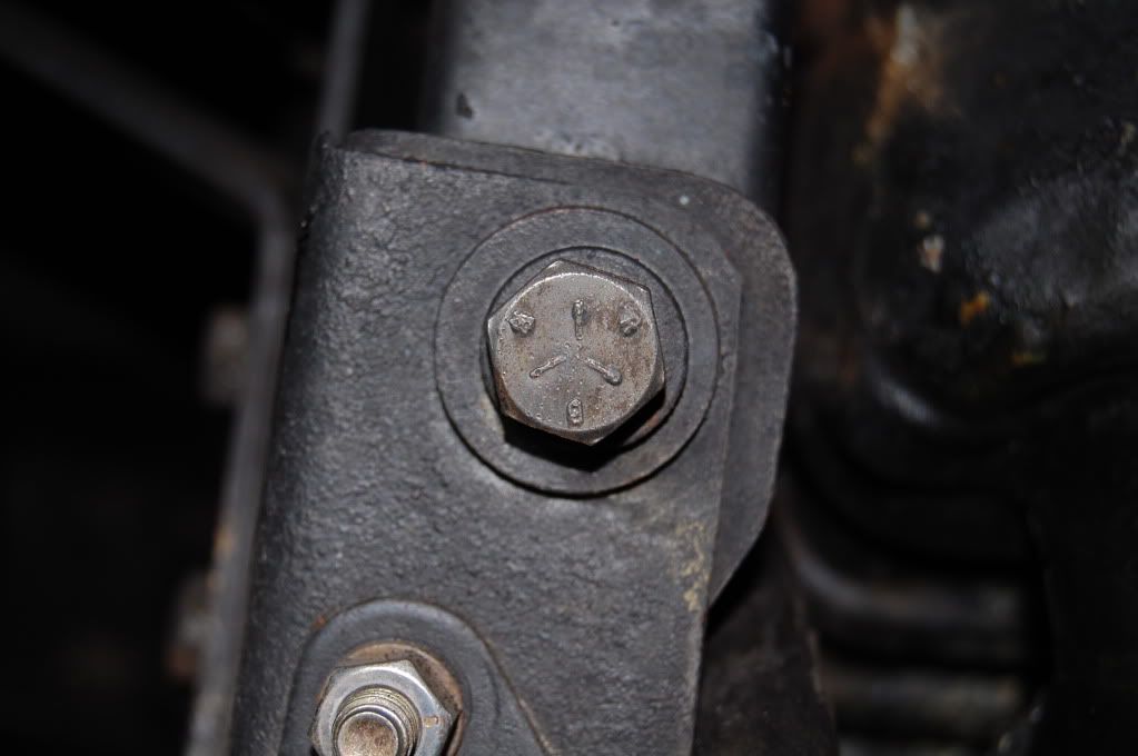

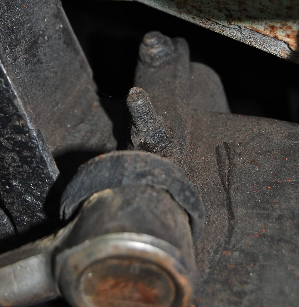

    4. Lower Control Arm Bushing Retainer Bolts- M with 6 lines.
    NOTE: My April 66 Car has TR Bolts in this location

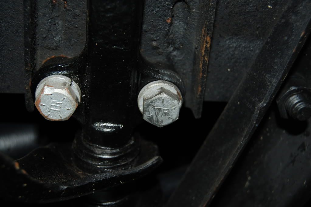

    5. Lower Control Arm Support- TR with 6 lines
    6. Lower Control Arm Support- Large bolt is Black Phosphate with TR headmark, nut and lock washer.
    7. Engine Mount Bolt- RSC Has pointed tip and lock nut

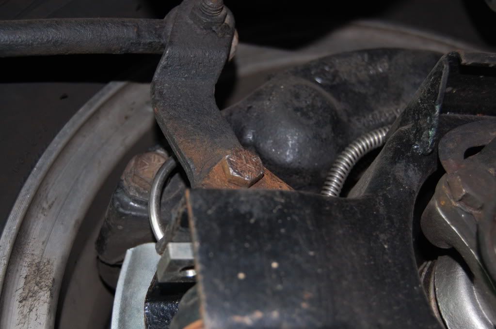

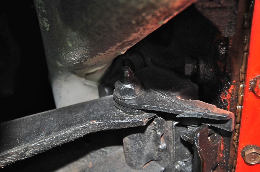

    8. Idler arm- Black phosphate carriage style bolt for lower mount with lock nut.
    Upper mount is(still need to look) with lock nut.

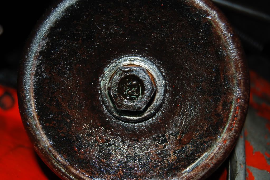

    9. Oil Filter bolt-AP
    10. Oil Pan Drain Plug-TR
    11. Transmission to Bell housing-WB I am not sure if these should be black phosphate or cadmium plated.

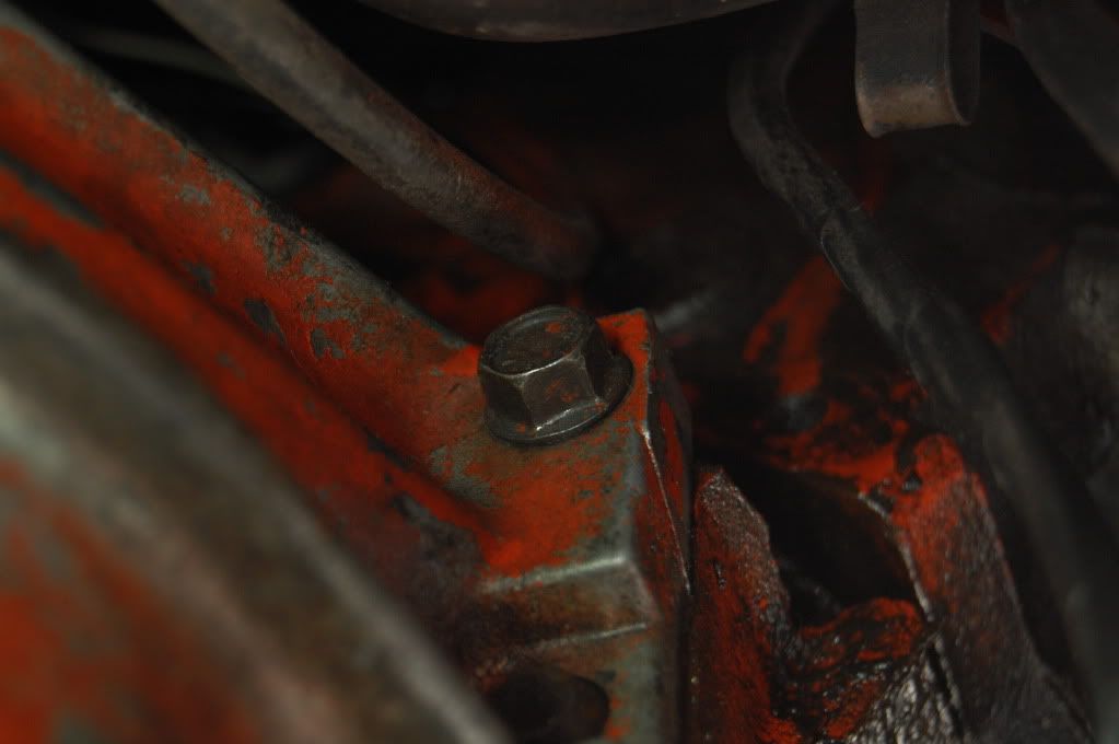

    12. Bell Housing to Block- RBW flanged head
    13. Transmission Mount to frame bolt. CP with circle. Lock nut with raised dots on nut and one round hole/indent
    14. Transmission mount to transmission bracket. WB 6 lines
    15. Transmission Mount to transmission. M with 3 lines

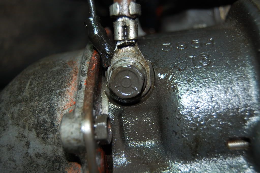

    16. Starter Motor to Engine Block bolt. Circle with 3 lines

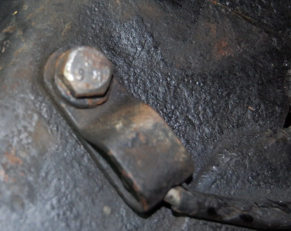

    17. Brake line to frame bolt. L
    18. Emergency Brake Cable to frame mount. WB
    NOTE: Headmark is the same for the bracket at the firewall.
    19. Shifter Mount to rear of Tranmission Crossmember. Flanged head, no mark.
    20. Seatbelt Cable to Frame. RSC
    NOTE: On my April 66 Car, the mark is TR

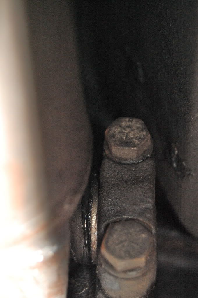

    21. Big Block Differential Cap Bolts. RBW with 3 marks/lines. Black Phosphate.
    22. Differential Mount Bolt, Rear. M with 3 lines Passes through mount and differential from Passenger side to Drivers side.
    23. Differential Bracket Mount Bolt, Front P with 3 lines, pointed tip. Uses castle nut and cotter pin. Passes from Driver's side to passenger side.
    24. Differential Bracket Mount Bolt, Front. Passes from top to bottom, through the frame and cushion assembly. I believe this has a WB headmark, but i am not 100 percent sure.

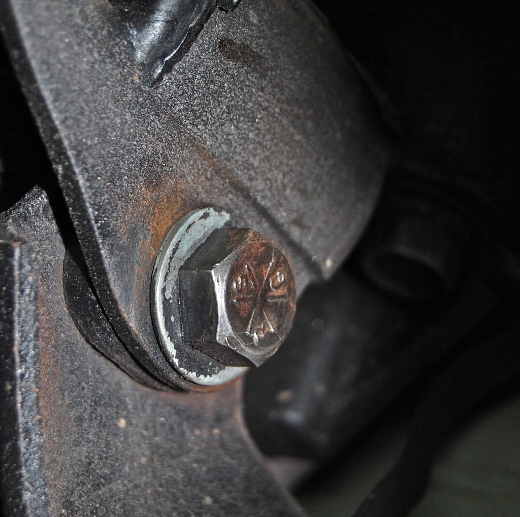

    25. Strut Rod Bracket to Differential. S with 6 lines
    NOTE: On my April 66 Car, the headmark is WB with 6 lines

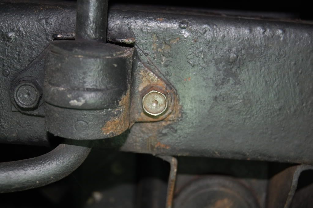

    26. Rear Sway Bar to frame bolt(note shims). Flanged head with RBW
    27. Sway Bar to Rear Trailing Arm. RBW

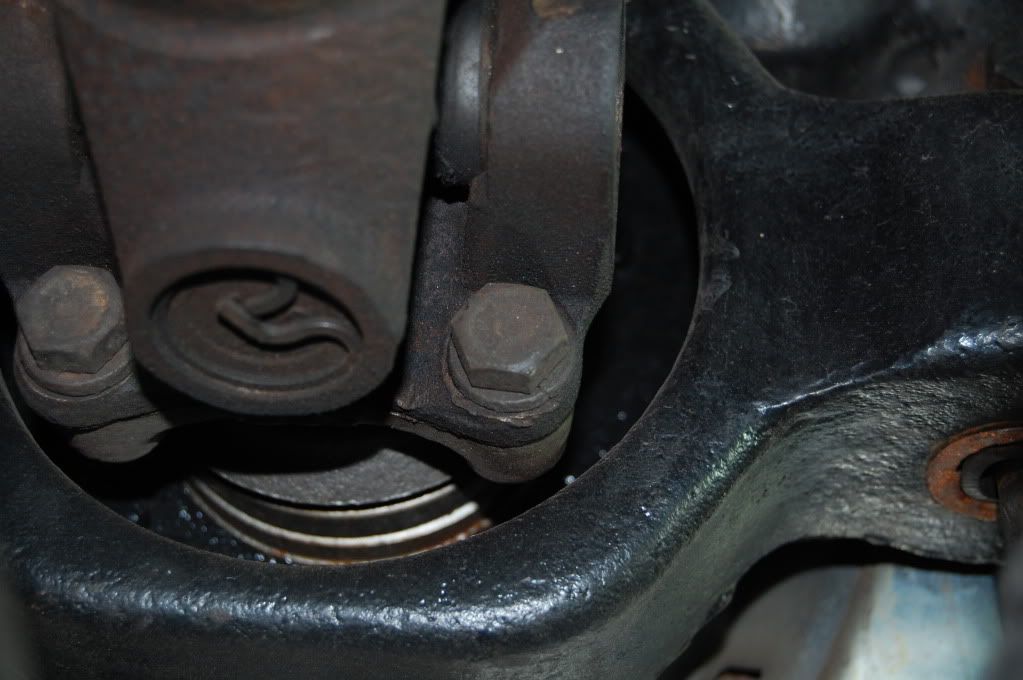

    28. Half Shaft to Axle Flange. Small inner circle with 3 lines. Black Phosphate
    29. Rear Differential Crossmember to Frame. Possibly WB, possibly nothing with 6 lines

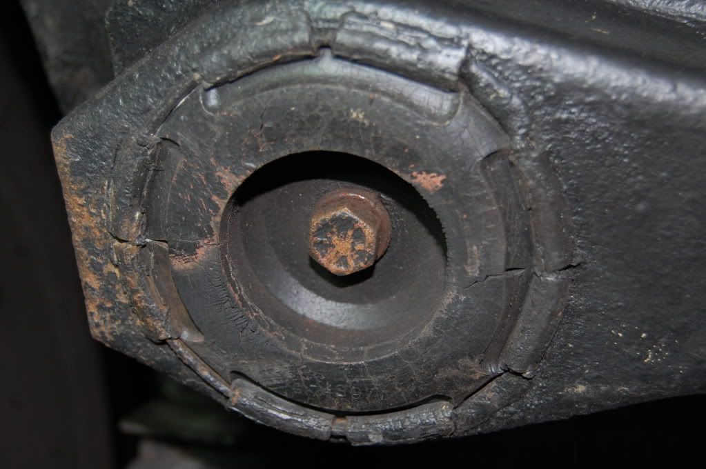

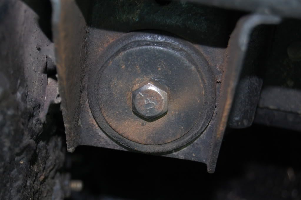

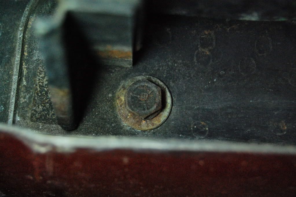

    30. Rear Body Mount Bolts. I find this to be very interesting. The bolt on the Driver's side is UR with 3 lines and the Bolt on the Passenger side is RSC with 3 lines. I would say that one is a replacement, but.....
    NOTE: My April 66 car is the exact same.
    That is all for now. I will post more when i have them. I have only posted bolts that i am 99.9999999999 percent certain are in their correct location. I did not post any of the bolts that have been replaced or that i know to be incorrect.

        -#4-Which bolt would normally be used in the rear sway bar mount to frame location? I do not have the same ones on my 66, but i just assumed that i chose the wrong ones out of the bolt pile that came with the car.

            Has anybody else observed the two different head markings, UR and RSC for the rear body mount bolts??? Like i mentioned in the initial post, i thought that this was a mistake on my car or that a bolt had been changed, but my father's 66 has the same thing.

              UR is correct. RSC is most common but UR was widely used. Check the mount at the firewall and see if they are UR or RSC.
