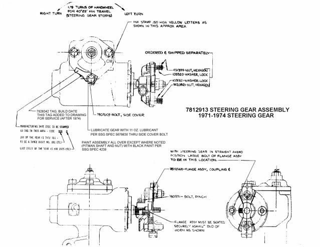

      This is a partial scan of the Corvette 1971-74 Steering Gear Assembly drawing. The drawing calls out "PAINT ASSEMBLY ALL OVER EXCEPT WHERE NOTED." The only exception called on the drawing was the pitman shaft and nut.
      A question would be that the flexible coupling assembly had threaded bolts that attached to the steering column. There was not any mention that those threads needed to be protected since the car assembly plant had to install nuts and lockwashers on those bolts when they attached to the steering column flange.
      Possibly the flange and coupling assembly was not assembled to the gear when it was painted. If so, then the input shaft should have been called out as a paint exception.
      Very confusing. All of the gear assembly drawings from 1963 through 1982 carried the exact same paint note and the pitman shaft and nut exception.

                          Point of clarification: I use the terms "flexible coupling assembly" and "flange assembly" interchangeably.
                          Note: During this period of time (1965-66) there were two gear assemblies released for the C2 Corvette. The gear assemblies were only different in the style of flange assembly attached to the gear as it was shipped to St. Louis from Saginaw.
                          Some more confusion. The Corvette flange assembly drawing 5692974 (1965-66 with telescoping steering column) has a paint note. The 1963-66 flange assembly 5690809 used on Vettes with standard (non-adjustable) columns does not have a paint note.
                          The 5692974 flange assembly carries this note:
                          "Paint assembly with SSG Code #4239. Paint in serrations and tapped holes must not be detrimental to function or assembly of part."
                          Now this part does not have attaching shoulder bolts like most flexible coupling assemblies. But it has pinch bolt flanges on each side that require pinch bolts. One pinch bolt would have clamped the flange assembly to the steering gear and would have been attached at Saginaw. The other pinch bolt would have attached the steering gear and flange assembly to the steering column at the St. Louis Corvette Assembly Plant.
                          Now meeting the paint note spec on this flange assembly drawing could have been accomplished if the flange assembly was attached to the gear at Saginaw and then the entire gear and flange assembly painted black as the gear assembly drawing sort of indicates. So regardless as to how you interpret the Saginaw drawing(s) both the steering gear and the flange assembly for the Corvette with telescoping column should have been painted black as they left Saginaw.
                          However, the flange assembly used on steering gears that attach to the 1963-66 Corvettes with standard (non-adjustable) steering columns did not have a paint spec on the flange assembly drawing. (In fact, I cannot find any other Saginaw flange assembly drawings with any sort of paint note.) Even though this flange assembly has shoulder bolts and two threaded attachments, the assembly would have been bolted together before being painted as an assembly. So paint on the bolt threads would not have been relevant.
                          So this flange assembly might have been painted if it was already part of the steering gear assembly and that assembly "painted all over" at Saginaw before shipping to St. Louis. Or the gear was "painted all over" and the flange assembly attached to the gear after painting and then shipped to St. Louis.
                          Jim

                            I do have a service parts list for the 7806900 (1968-69) steering gear assembly. The parts list indicates that the flexible coupling, pinch bolt, and the "AM" alpha code sticker should be eliminated.
                            A new alpha code label "BT" added and a cardboard protector tube installed on the input shaft.
                            There is no mention of deleting the paint from the gear assembly.
                            The last gear assembly drawing that I have is 7819668 which went into production the 1975 model year through the end of C3 production. Revision "G" dated 2-12-75 eliminates Note #10 which was the "Paint All Over" note. Possibly after the paint was eliminated from this production gear it was decided to just eliminate paint on all Corvette service gear assemblies.
                            Jim
