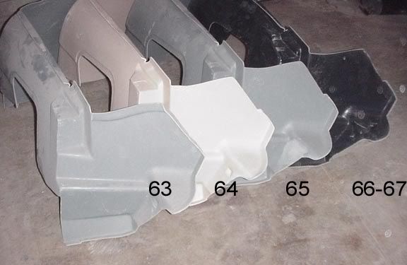

                    These are all reproductions, but they exhibit the correct configurations. You will note that 63-64 have a dimple at the point in question, and on the 65 it is slick. It was added back in 66-67. There are several other differences though.

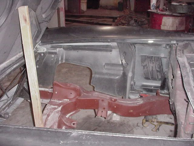

                        Interesting information... I learn something new every day about my car thanks to you guys! Thanks for the great photo, Wayne. Do the current attached photos give any additional clues to my particular inner fender situation? Not sure that I understand the "relief" that you are referring to, John? Is it the bump where the hole is located in the fiberglass as shown in Wayne's photo? I assume at this point that my inner fender on the passenger side was a service replacement. I need to look closer at the driver side to see what is happening there.

                          I guess I mis-spoke, my inner fender is a 66-67 inner, not a service replacement.
                          John, I'm not an expert but it looks like your inner fender is something other than a 65. I think you'll have to show a better pic of the inner fender from the engine side to verify. Your car looks good by-the-way.

                            After 65 production, the service part would have been the 66-67 style. In addition to the dimple, the RH side hood support mount was flat with the hood hinge mount. On the earlier years it was slighty raised, and in the rear area where the expansion tank is mounted, there is a sharpe square corner.
                            66-67 style, and replacement.
