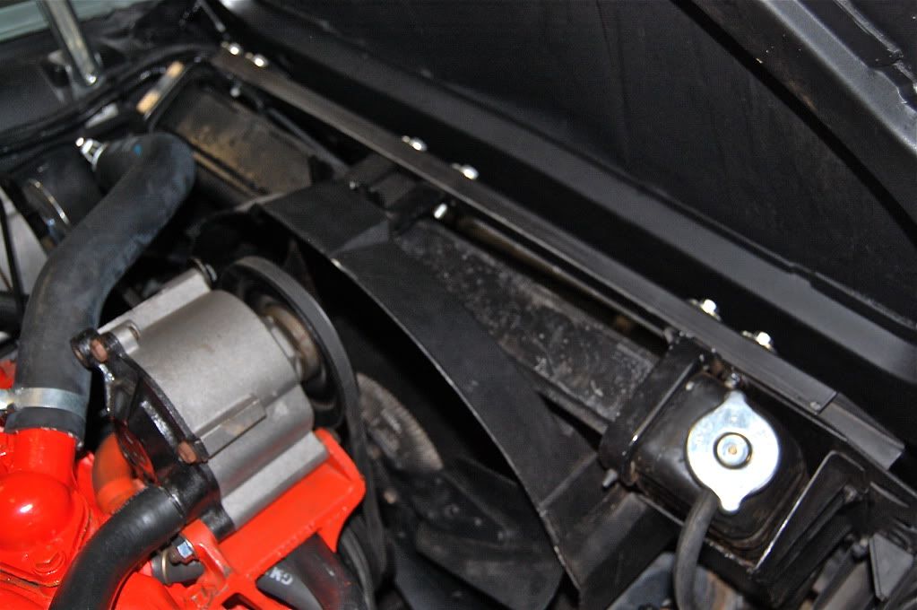

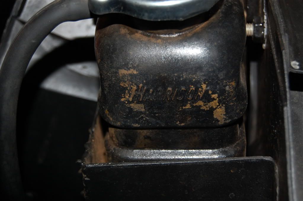

                    Update:
                    Here is a picture of the radiator that i currently have installed in my car. I'm not sure why i thought it had different end tanks, but they appear to be the correct design.
                    The second set of pictures are a radiator from another 66 Corvette, which is local to me, and it appears to be a correct replacement or an original. The owner of this car is upgrading to an aluminum radiator and i have the opportunity to purchase the radiator for cheap, but before i do so, i wanted to post pictures and get opinions on it and the one i currently have installed.
                    I can't find any tags on either of the radiators, but they both have passenger side tanks with the Harrison name and fill instructions.
                    Thanks!
                    Radiator 1-currently installed
                    Flat top, no notches or cut outs.
                    Radiator 2-Have the option to buy
