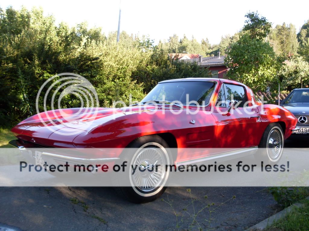

    I am going to change all the brake lines and all the clips on my 64 coupe
    The front to rear brake line sits on top of the frame(with clips and screws)which i hope is not to difficult to access?
    I am bit worried about that the brake line is on top of the frame will be difficult to change since it is on the top on the frame on the drivers side.
    I hope that there will be no problem doing this without having to lift the left side of the body off the frame a little?
    There is\was no rust(not even surface rust)on the frame before i spray painted the undercarriage
    Any good advices on how i should do the brake line work? I sure will need them
    The car that is going to get new brake lines
