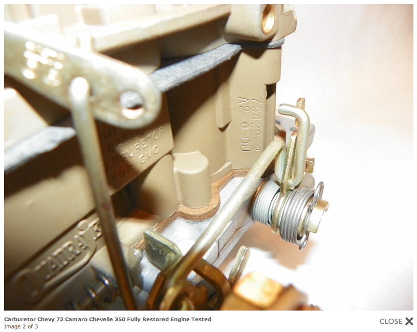

    Working on bringing some of the parts and numbers on my 1972 into closer alignment with the findings from a recent flight judging. One of the things we identified is that the carb on the car was not the technical correct one so I located and purchased the correct one.
    Interested in advice, tips and information on the correct process to swap this out. Sure.. I could pay the local shop to do it... but with the wealth of knowledge here and a little hands-on, perhaps I'm underestimating what appears to be a straightforward swap. That said, I'd like to give it a shot.
    The engine is a 1972 350/200hp (non LT-1). Car has automatic trans and air.

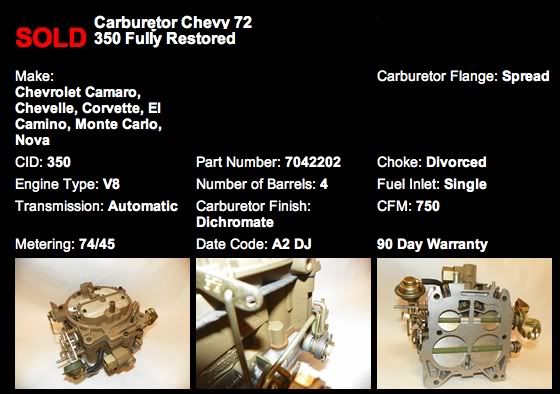

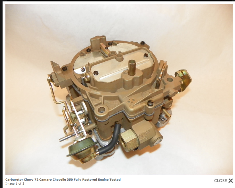

    Carb that's on there now is a 17054931. One I purchased is a 7042202 A2 DJ.
    Carb has been fully rebuilt, tested and tuned to exact factory specifications by the shop I purchased it from.
    Here's the new Carb:

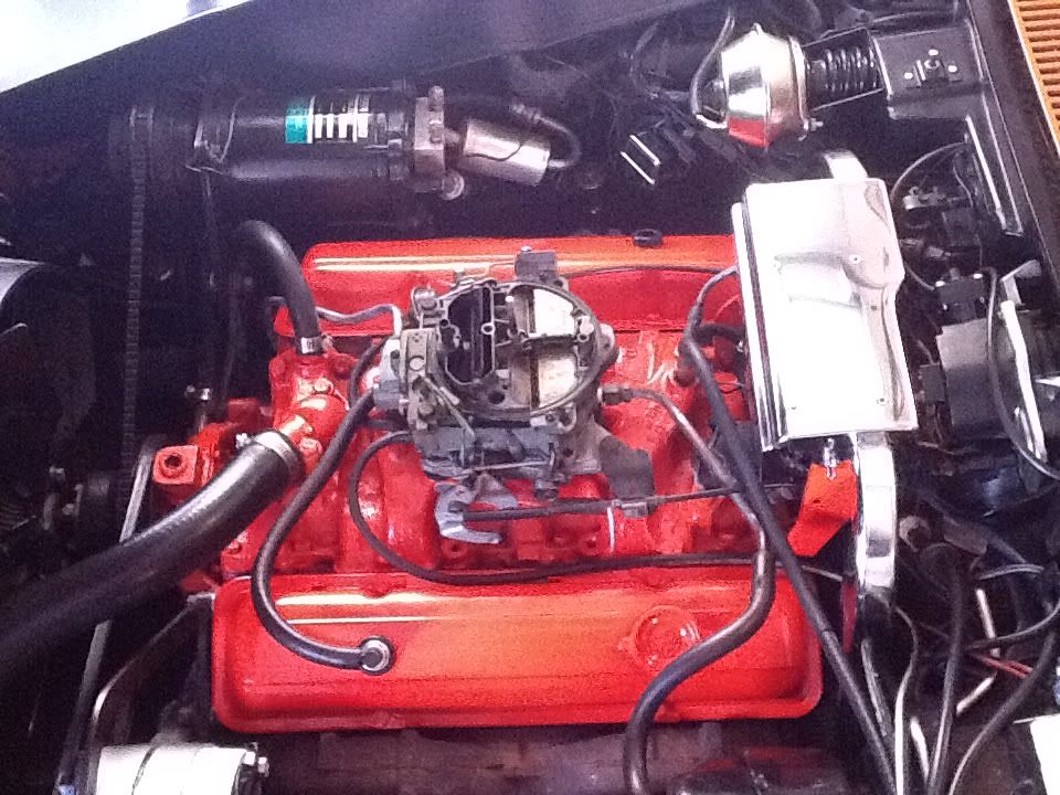

    Here's what's there right now...
    In looking at my current set-up, would the process be to:
    1. Remove linkage / connections from LH side
    2. Carefully disconnect fuel line and vacuum connections from FRONT.
    3. Disconnect connections and vacuum connections from RH side.
    4. Disconnect brake booster connection from REAR.
    5. Unbolt carb from manifold
    6. Remove center stud
    7. Remove Carb
    8. Remove old gasket
    9. Place new (gray colored) gasket
    10. Set carb and lightly apply nuts
    11. Attach gas line FRONT
    12. Attach power brake line REAR
    13. Use X pattern to tighten bolts slightly above hand-tight.
    14. Connect vacuum hoses.
    Is this pretty much it?

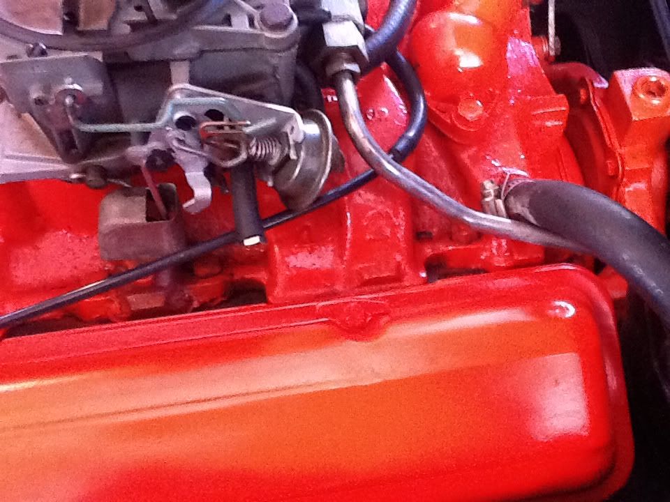

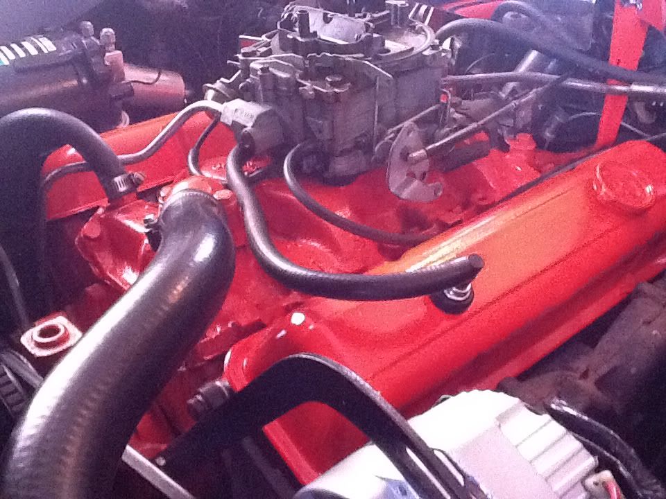

    Scott, It looks like you have it covered, don't use any sealer on base gasket or teflon tape,as the factory did not use.
    There were a few things I noted with your 72 vacuum hoses, the driver side the PCV valve and the small w/stripped hose was taped together with friction tape. you have it routed behind the vertical shield it goes in front. the hose that is plugged is the for the TEC solenoid.

      Looks like you pretty much have it. As for the gas, there won't be much, but have a couple of shop towels or paper towels ready to clean up the mess. It's really a pretty easy project. No sealants or silicone needed. If you've not done it before take some masking tape and wrap it around the hoses, then mark them with numbers. Print your pictures and put corresponding numbers on the photos as a guide to where you took them off. Take it easy, don't force anything and you have it made. As for the teflon tape, I use it just as a precaution for leaks an make sure it's not visible once I get the fitting tight in the inlet. It's not needed, but what can it hurt. Right?

            Scott..the carb looks great! It does look like you have everything covered for the installation.

                Use a big wrench on the nut on the carb while using a flare wrench on the fuel line.
                Connect fuel line at least partially before dropping the carb onto the manifold and trying to tighten the hold down bolts; i.e. swap your step 10 and 11. You can't attach the fuel line once you bolt it down. Trust me on this one.
                I still think the carb date is too early.
                This is not a tough job. Just be methodical about removing all the attaching parts and then reversing it to install the new one.
