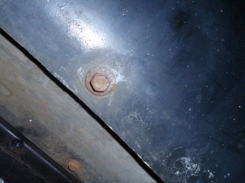

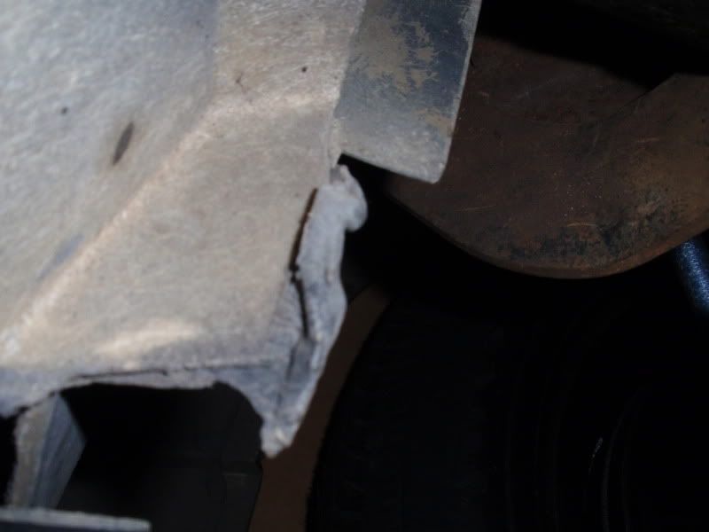

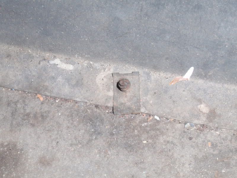

        Don,
        From my original 60.
        Tom
        Edges are bonded, pretty sloppy too
        Bolt side:
        Clip side

          Tom thanks for the pictures,
          Looks like mine screw will work.
          Is the baffle bonded to the fender skirt only as per what I though the AIM shows? Or, is it also bonded to the lower front nose of the body panel?
          Also, do you have three of the screws holding the baffle to the nose?

            Baffle appears to be only bonded at the skirts.
            Yup, three screws.
