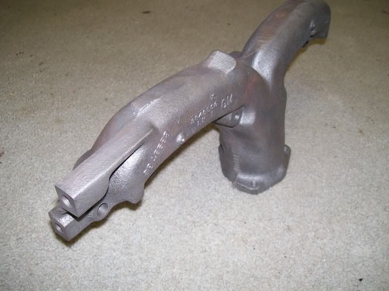

                This is an NOS GM 64-5 style LEFT manifold (563) for an alternator.

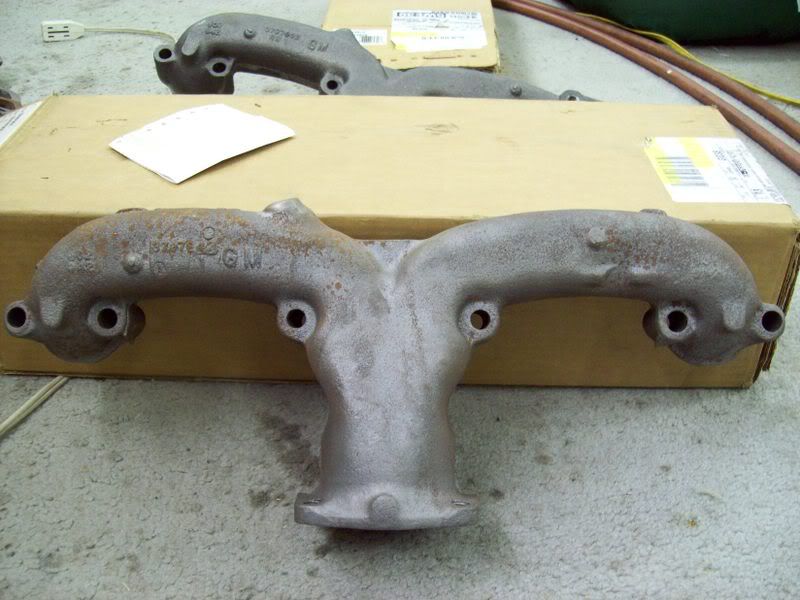

                This is the "plain" 942 style, which depending on engine/option configuration, was used on EITHER the left or right side. The 942 was ONLY installed on production cars. It was NOT available as a service replacement.
