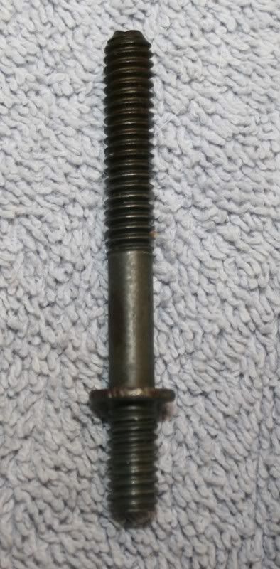

              The stud pictured above is from my 69 L89 and is 2" from tip to tip. I am currently restoring a 67 L71 and the carb stud is the same.
              Kramden

                Re: 67 carb stud
                It appears to me that the 2" stud pictured above is GM # 3869954. The thread lengths appear to be 1/2" and 1" (or maybe 1 1/16") based on counting the number of threads as there are 20 threads/inch (1/4"-20).

                    Re: 67 carb stud
                    I'm sure the 67 guys will chime in but, in the meantime, I would say the stud I pictured is but one example of an acceptable original.

                        Here's is a couple of pictures of the original stud that is in my June 67 435
                        It is the same as the one that Mark has pictured including the shape & indentation of the the tip.

                          Re: 67 carb stud
                          Good example showing rolled threads. Notice the peak of the thread is not sharp like cut threads.
