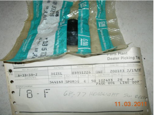

    Headlamp Knob
    "In 1970 and 1971 there is black bezel behind the switch with the word LIGHTS in white"
    On my 1972, the same black bezel with the word LIGHTS exists. I have also seen NOS replacement bezels specifying the year as 1972. Every 1972 I've seen has the same bezel.
    In the current wording, I have experienced it being interpreted to exclude 1972 such that this bezel is incorrect on a 1972. Which seems incorrect.
    Is this a matter of updating the 1972 TIM & JG to include 1972 in the description?

      The wording on the headlight bezel can looked at for clarification.

        On the other hand we could probably find many parts of the car that are not mentioned in the TIM&JG and if we assUme those also don't exist we would be judging very incomplete cars. Like all 1972s have no bezel behind the headlight switch just because it is excluded by what is likely a typo.

                Pretty sure my Top Flight '72 has the pictured bezel. She's put away, under the cover and up on the lift, but if you want me to, I'd be happy to bring it down and take a photo for you and others that are considering this detail for TM & JG revisions.
                Lemme know - it would be no trouble at all

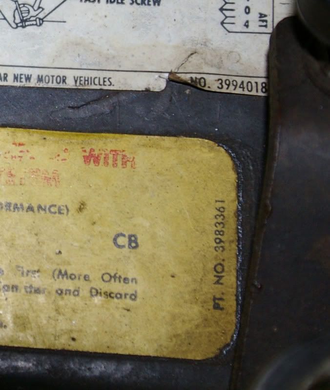

                  While we are on the subject of a future 70-72 manual update, I like to request that the part number for the yellow emissions label be corrected. I pointed this out prior to the current release, but I may have been too late.
                  The guide shows the part number as 3989361, the one in my car (sept 70 build, 1971 LS5, S/N 1632) has a number of 3983361. Plus the guide states up to S/N 1455, mine is S/N 1632. Reference page 74.
                  This is such a great resource and as Scott mentioned earlier, fixing these tiny things will make an already great guide that much better.
