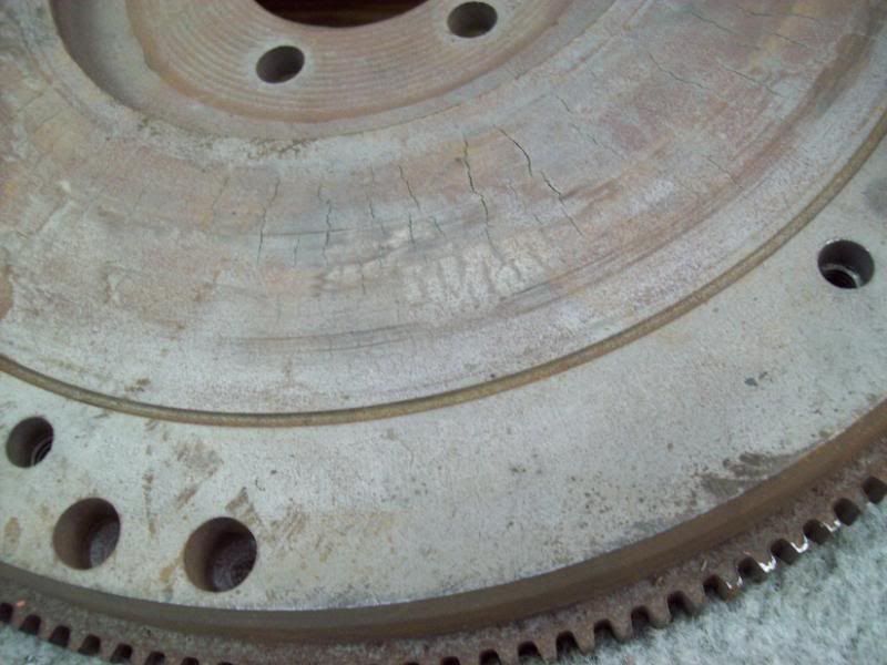

      Also, the early 168 teeth flywheels had a groove cut into them so that an 11in clutch could not even be used.
      Beginning in 63, the smaller, 153 teeth flywheel was introduced and ALLLLLLLLLLL Corvette engines up through 65 (including the 65 396) only got the smaller flywheel/10 1/2in clutch. Then in 66 they went back to the larger 168 teeth flywheel.
      SOOOOOOOOOO, yes, you can physically bolt a 55-62 flywheel onto a 68 BB crankshaft and it will work fine. BUT, if it is one of the flywheels with the groove cut into it (shown below), you are limited to using a 10 1/2in clutch.

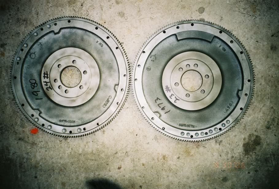

      As I mentioned, ALL 55-85 flywheels are a direct, bolt-on interchange. BUT, for the SB400 and the 454BB engines, the flywheels were UNbalanced, or external balanced if you prefer. That is, they had an additional weight added on the front side of the flywheel which was needed for balancing the rotating assembly (the harmonic balancers were also UNbalanced).
      Here is a comparrison of a neutral balance and an external balance flywheel (used on SB400 and 454 engines). All PRODUCTION external balance flywheels were ONLY the larger 168 teeth version. There were NO PRODUCTION external balance 153 teeth flywheels.
