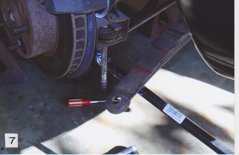

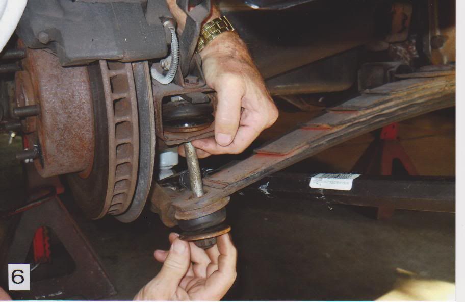

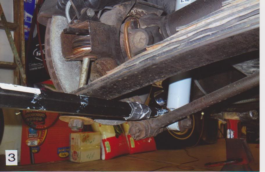

        Kurt
        I have written an article for The Restorer on this subject and I hope that it will be published soon. But here is an abridged version that is a simple and safe way to remove the tension on your spring bolt.
        It takes 2 people and a 6' or longer pry bar. One person to lift on the pry bar and one person to remove the nut from the bolt.

            Bill's pictures look like a nice method, and I am sure the story will look great in [i]The Restorer[i] -- better than it would look in The Driveline All the parts hunters would get mad if it were in The Driveline.
            Sorry Bill -- the devil made me do it.
            There are step by step instructions, complete with pictures, in your copy of The Chevrolet Chassis Service Manual. Why not read and see what the engineers who designed your Corvette had to say about this operation?

                Bill, I got that all the time when I was Restorer Editor. Eric and I joked about it a lot because he got compliments for his work on The Restorer. I am sure Vinnie gets the same thing now. It kind of comes with the territory, and it is why I put all those smiles around it. I wanted you to be sure to know I was ribbing you a little bit, and that is not always easy to do on-line.
                Those are some very nice pictures and it is a very interesting method. Thanks for thinking outside of the box.
