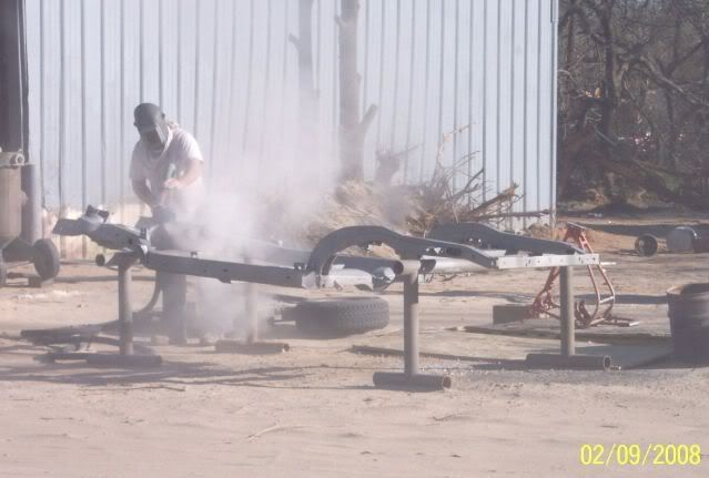

    If you're asking what will remove the rust.....chemical removal or media blasting. No cleaner I know of will "cleanup" rust. I choose to have the frame media blasted. After blasting I coated the frame with zinc chromate self etching primer. Next painted the frame with chassis black.
